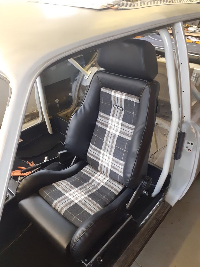

This is my very first go at any upholstery, so be gentle. Its not perfect, but not bad for a first attempt ?
#9603
@B1N9S ,
Brave man. I have 02 sitting here and 02 more in the chute. You did a great job! Interesting fabric choic though.
#9605
Dude! Thats actually a really really good for your first time! You should be proud. There are some areas to improve on but also know that that style of seat is one of the hardest to do.

Pulled this one apart over the last couple of days. It's been sat there for months. I am having a nightmare trying to sew the 4 way shoulder junctions.
I decided to sew a top stitch across the join, but for the life of me I cannot get that junction to sit correctly and have the stitching line up. I am tearing what's left of my hair out. I lost my temper tonight and just tore into the work I had done :rage: I have to start again.
:grimacing: :grimacing: I never realised sewing would be sooooo frustrating !!! :grimacing: :grimacing: :grimacing:

I calmed down last night, eventually and decided to cut some more patterns and to really take my time. I think I was not taking enough time, with measurements and accuracy with my patterns and setting the seam allowance. So, things just wouldn't line up.
I also learnt, that when a curve lines up to a straight line they are not they same lengths !!! Seems obvious, but I was ignoring a very slight curve, which makes a huge difference when you pull it all together. See the shoulders on my chair !!
I think, I've got it now. So, back to the machine. I'm loving it. I also made a carpet set for the car with binding and that looks pretty good and a perforated headlining, which I have fitted, which also looks great, so it's not all frustration !! :grinning:

Well. I'm still not happy with the results, but it's a learning curve.
I remade the top section and added a top stitch to the shoulders and I also changed the leg extender to vinyl.
Can anyone advise why I can't get a nice smooth fit around the seat, where the piping goes ??
#10586
looks to me like you need to steam the heck out of the under side of the seam right before installing. Also a tighter cover might help.
By B1N9S
#10598
I have managed to loan a steamer (just a domestic thing). I have no idea about the steaming thing. What does it do if you steam it before fitting ? Does it make the material stretch better ?
I will be doing this one again, but cutting the material 90deg, so the stretch is longitudinal.
#10602
Steaming the cover before you install it will relax all the tension in the seams and will make it lay flatter. It will also make the material much more stretchy allowing you to get a tighter fit.
