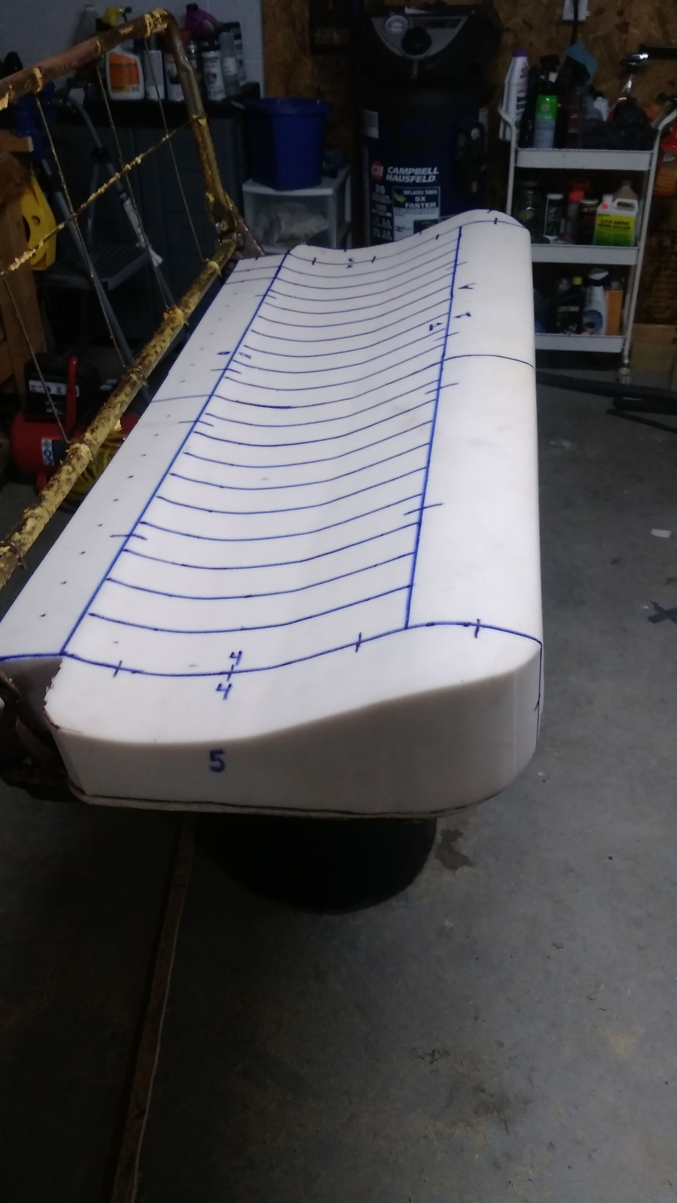

#12026
BigRig wrote: Sat Aug 11, 2018 3:54 pm @Todds34rod ,
Great Job on that new foam! How did you contour that to be so smooth?
Sorry, haven't been on here in a while.
That foam your talking about is a Bowen seat foam that I adapted to a stock frame.
I have made several with a band saw but it very time consuming.
I'll attach an example of their foams and frames. It costs more to buy the seat and frame but I feel the time savings offsets the extra cost.
using Styrofoam
