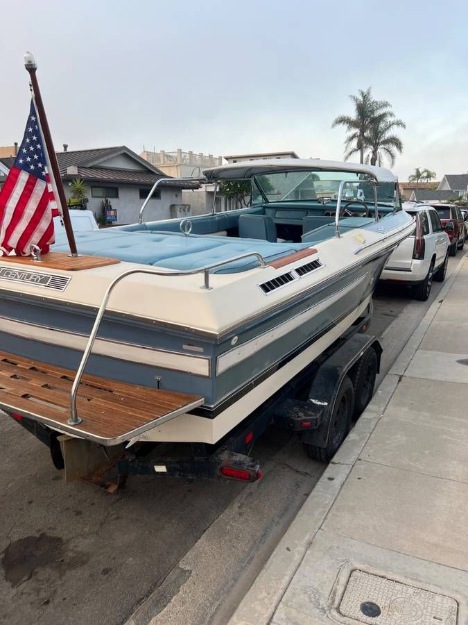

Here's a picture of a similar boat, it's not a very good picture but what I'm going to cover is the white area of the deck. As you can see, it has quite a few angles to it. The white continues as a harrow band all the way to the bow. My plan is a french seam at the bow with a top stitched seam in select areas at the transom. The radii are large so I'll have to pay attention where the seams will lie. Image Thanks LleeT -

#22136
So you want to cover a portion that was not covered before?
That would be dangerous, when boarding and getting off the boat, if the fabric is slippery or wet, it might cause someone to fall overboard
#22137
Yes. Actually in my boating experience, wet fiberglass can be more slippery than wet vinyl. My two previous boats had varnished mahogany, very slippery when wet and nobody ever fell overboard. One of my dad's boats had vinyl, again nobody fell overboard.
