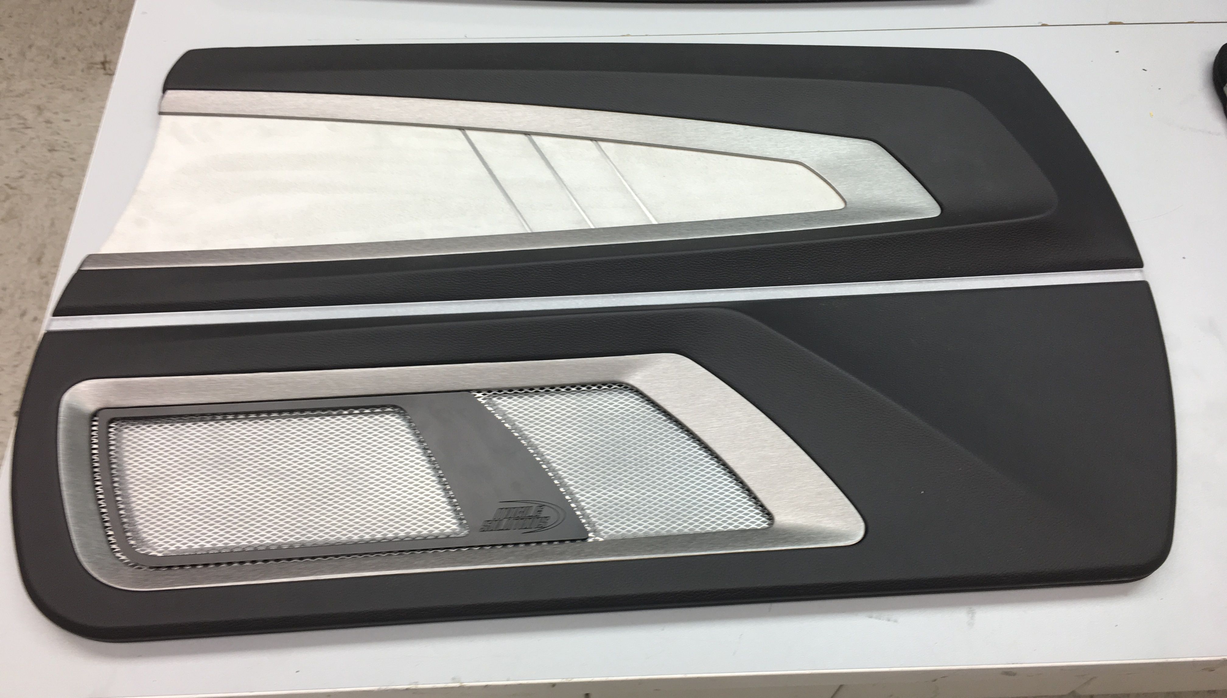

@Trimmerman79 I was just at the door panel class 2 months ago. It was really good. I learned a lot! I decided not to do the subwoofer class in June. Ive never really like or been interested in custom car audio. It was actually kind of strange. There was only 4 trimmers in the whole class. I waiting for them to do another center console class.
This was my panel

John wrote: Wed May 09, 2018 5:51 pm @Trimmerman79 I was just at the door panel class 2 months ago. It was really good. I learned a lot! I decided not to do the subwoofer class in June. Ive never really like or been interested in custom car audio. It was actually kind of strange. There was only 4 trimmers in the whole class. I waiting for them to do another center console class.
This was my panel
Great job on that panel. Looks fantastic! I have yet to making to any of the classes yet. I have a lot of friends that been. Since I’m in he car audio business. Yeah most guys that attend are going to be car audio guys. I love building car more then just building audio systems. Reason why I’m getting into upholstery, so I can do it all from start to finish. I know at one time they had a hotrod trimmer guy teach a class on sewing. Not sure if they still offer it or not. I’m going to watch your online videos.
