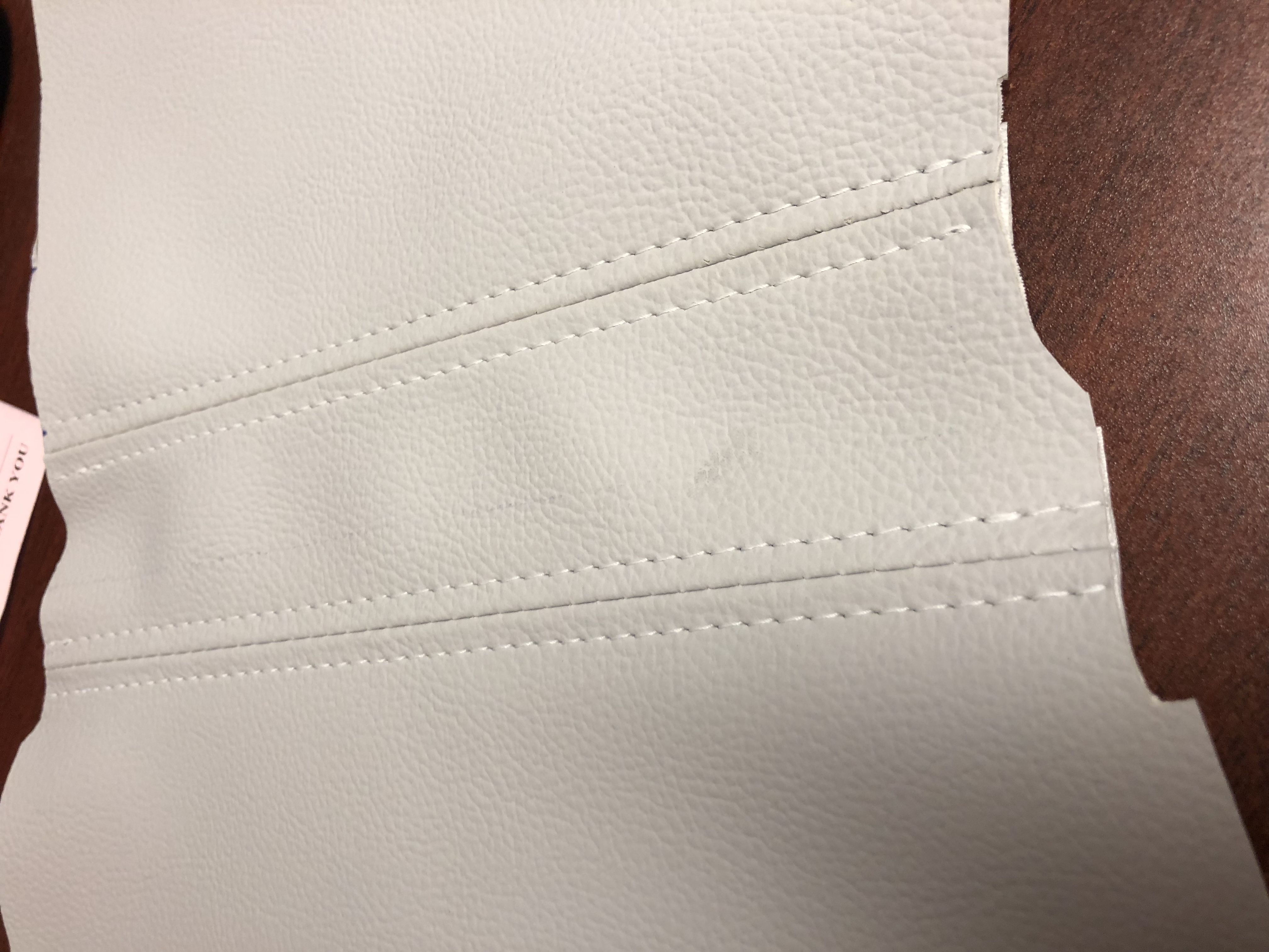

@Cody, thanks, i like the fiberglass to but needs updated to flow with the rest of the build I'm doing on the car. It has a clutch motor on it now and has a pretty small pulley on it already. Not sure if i can get a smaller one or just need to learn the machine better to control it. @IvanD I'm still working on that. I have the top tension almost all the way out and its still doing it. This was after i figured out how to adjust the bobbin tension. I have no manual with this machine. Not sure what else to do. I think it could also be because I'm using a #22 needle on the 92 thread. My new #19 needles haven't showed up yet.
#3137
I am actually practicing same thing. Needle size definitely going to make difference. With 22/69 I had similar issues. Tension might be OK but hole is too big and it shows.
Picture from my excersize last night. #20 LR needle. Have 19 in R kind only, but I checked with both almost no difference. On my material LR makes better bortom stitch
