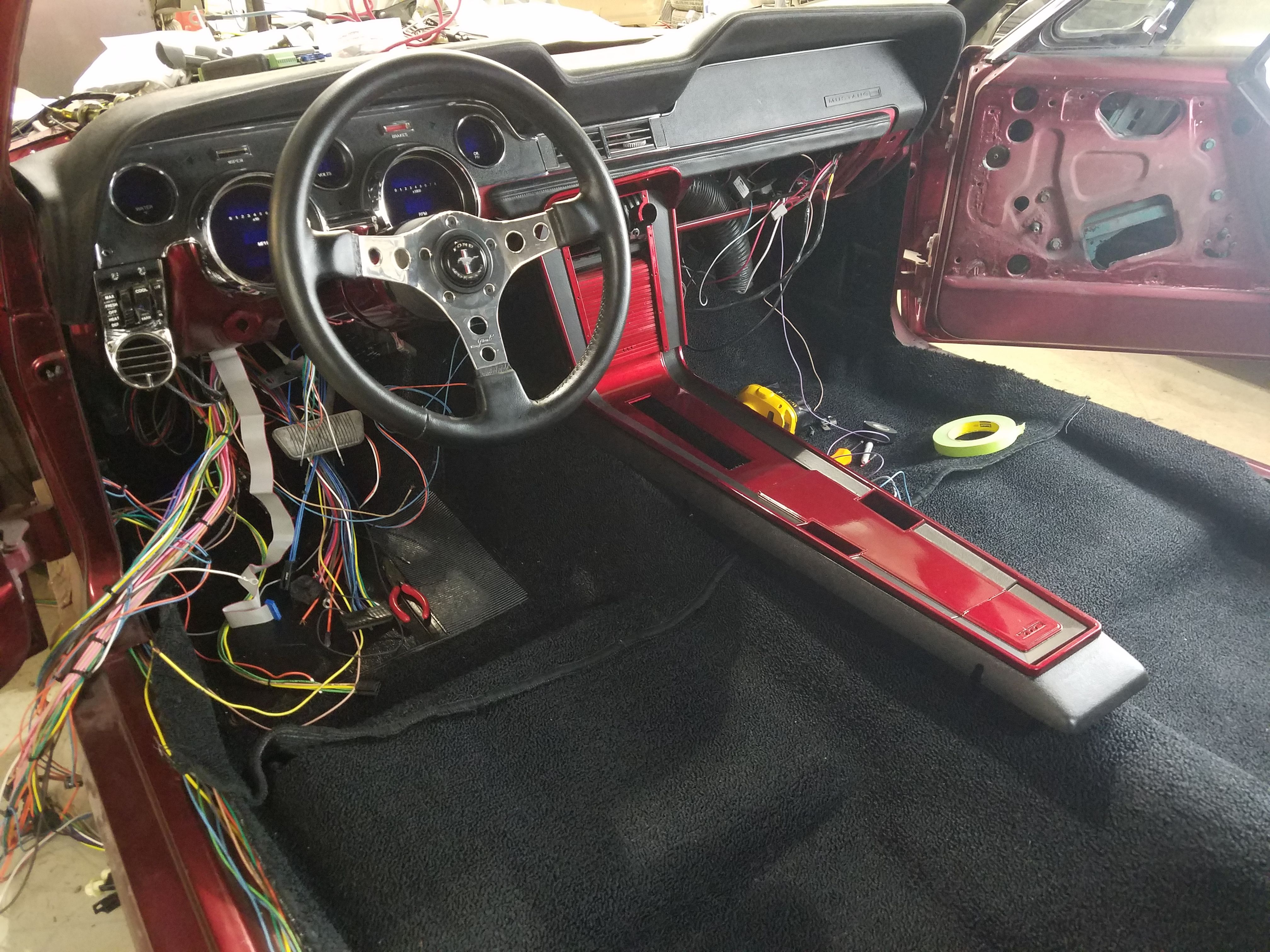

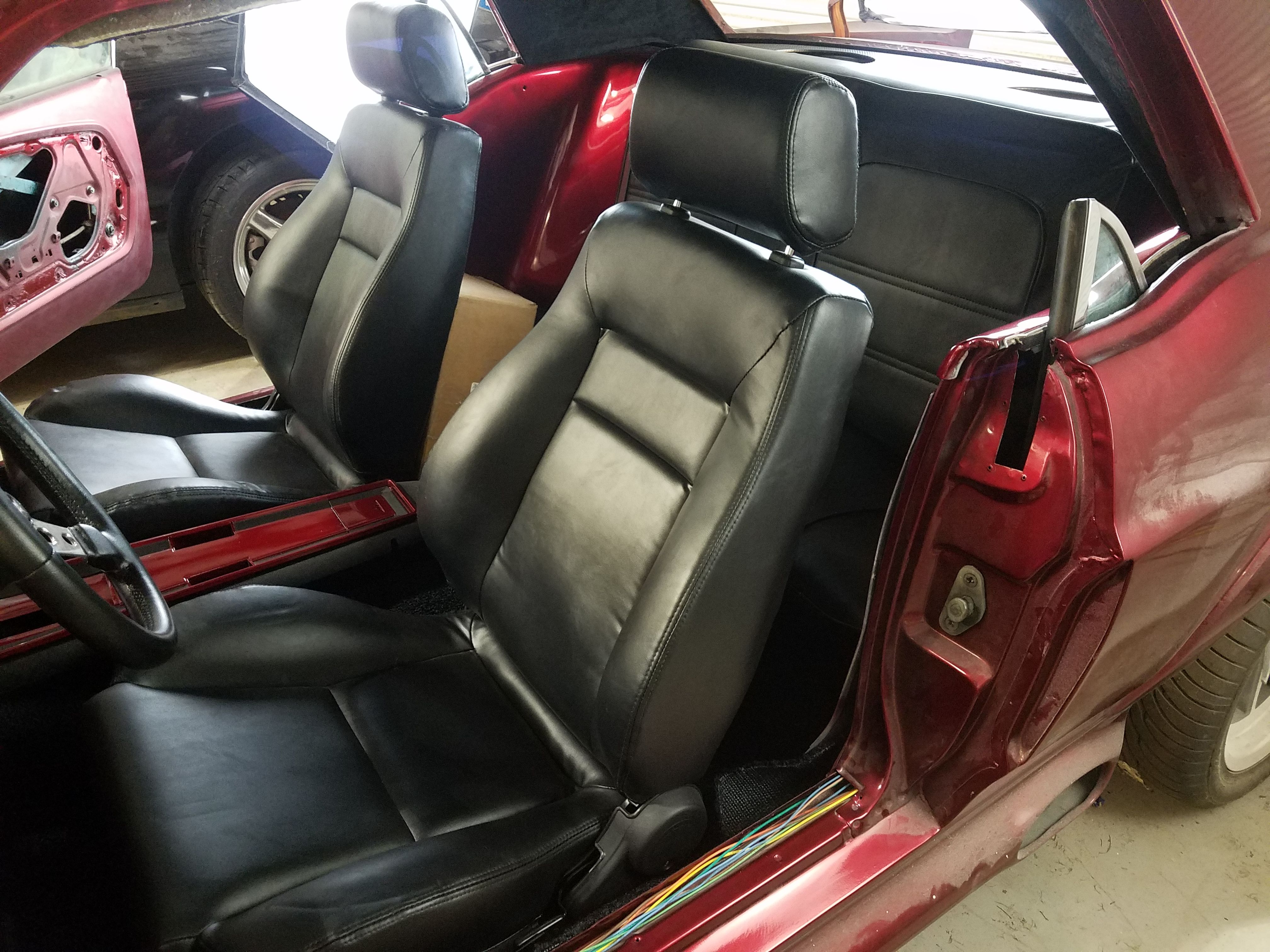

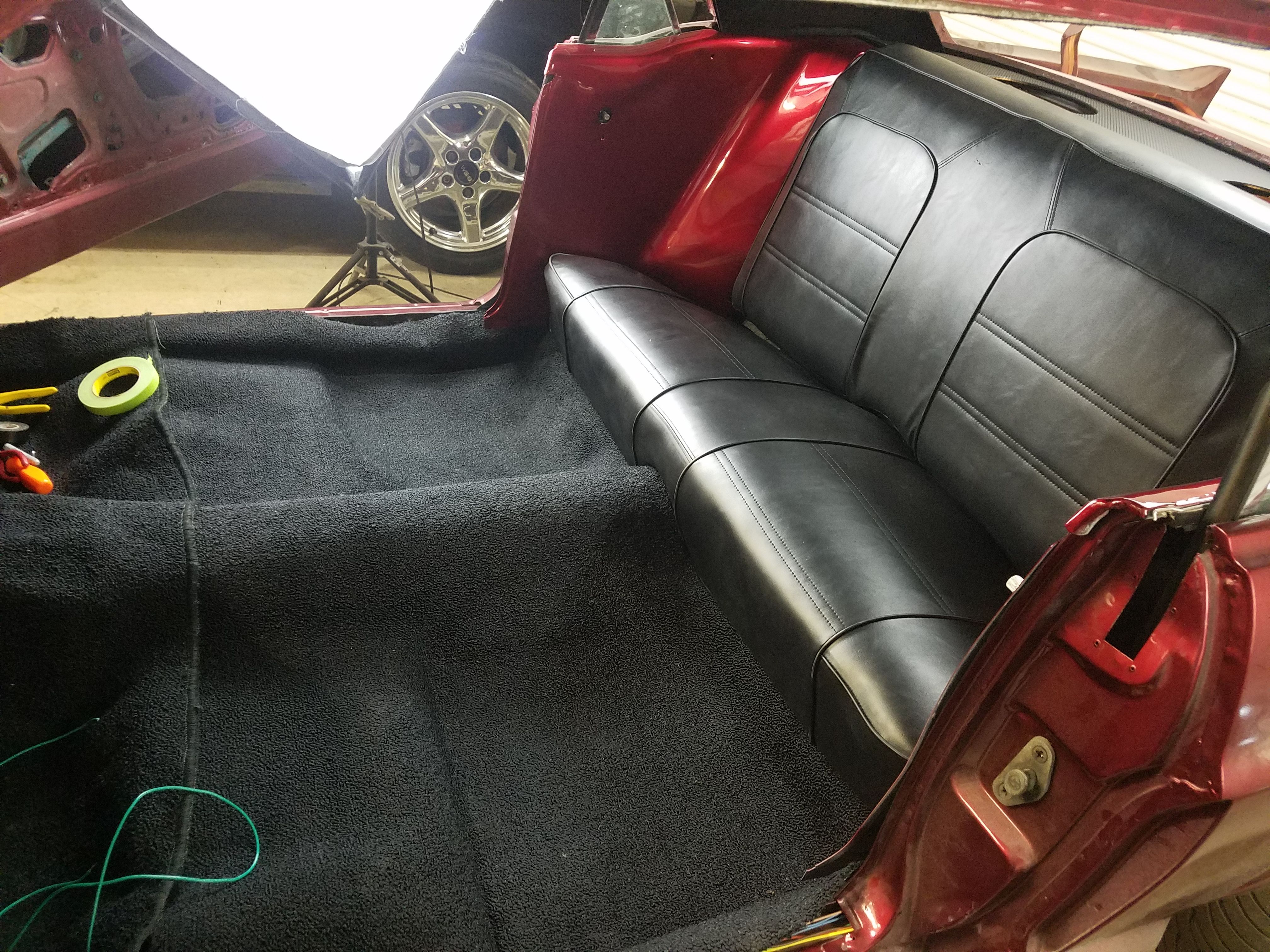

I was wondering what order everyone builds their full interiors? Headliner, Carpet, Panels, Seats? Interested in everyone's school of thought on why. My first full interior starts September 3! Here she is.
