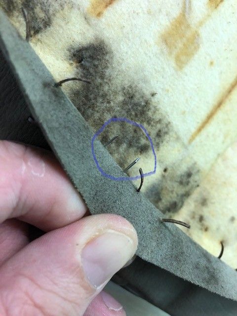

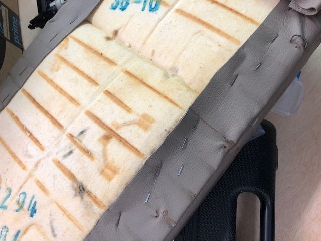

See pictures. Bottom of a seat is basically foam and leather wrapped and stapled to the bottom. Those staples go sideways when in a foam and thats how they hold. I got upholstery staple (shoots T50 staples) but it goes straight in and obviously there is not much holding power.
The question is what should be used to shoot staples just like original? And if not, what is the proper way to recover such pieces?
#3118
Factories get access to all kinds of strange supplies and tools we don't. A lot of times its up to us to come up with ways to make it work with what is available to us. I would test to see how much holding power your staples have and make a decision based on that. Technically the tension should be pulling side ways on the staple and not up. So hopefully you will be fine. If not I would use contact cement and also staples.
