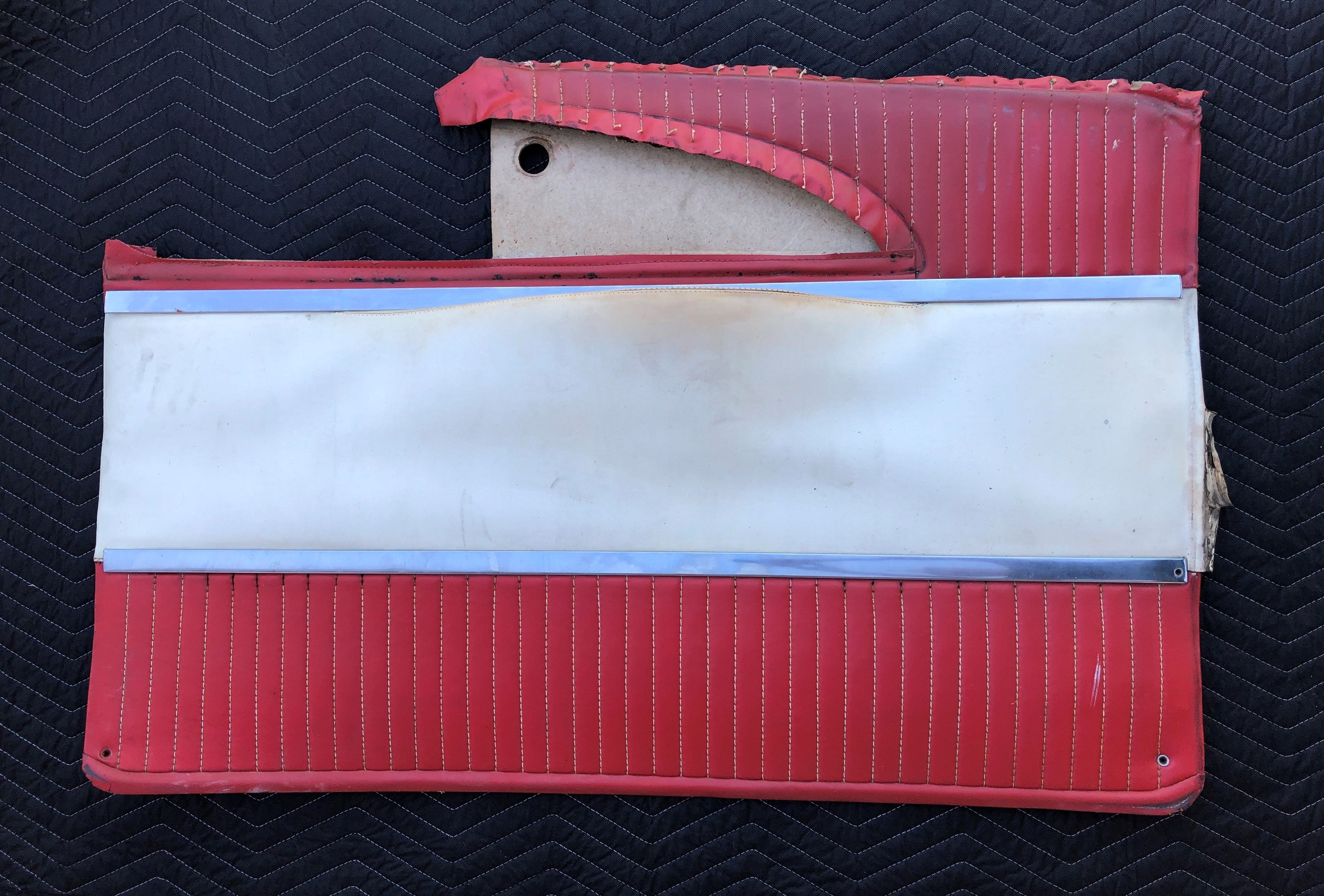

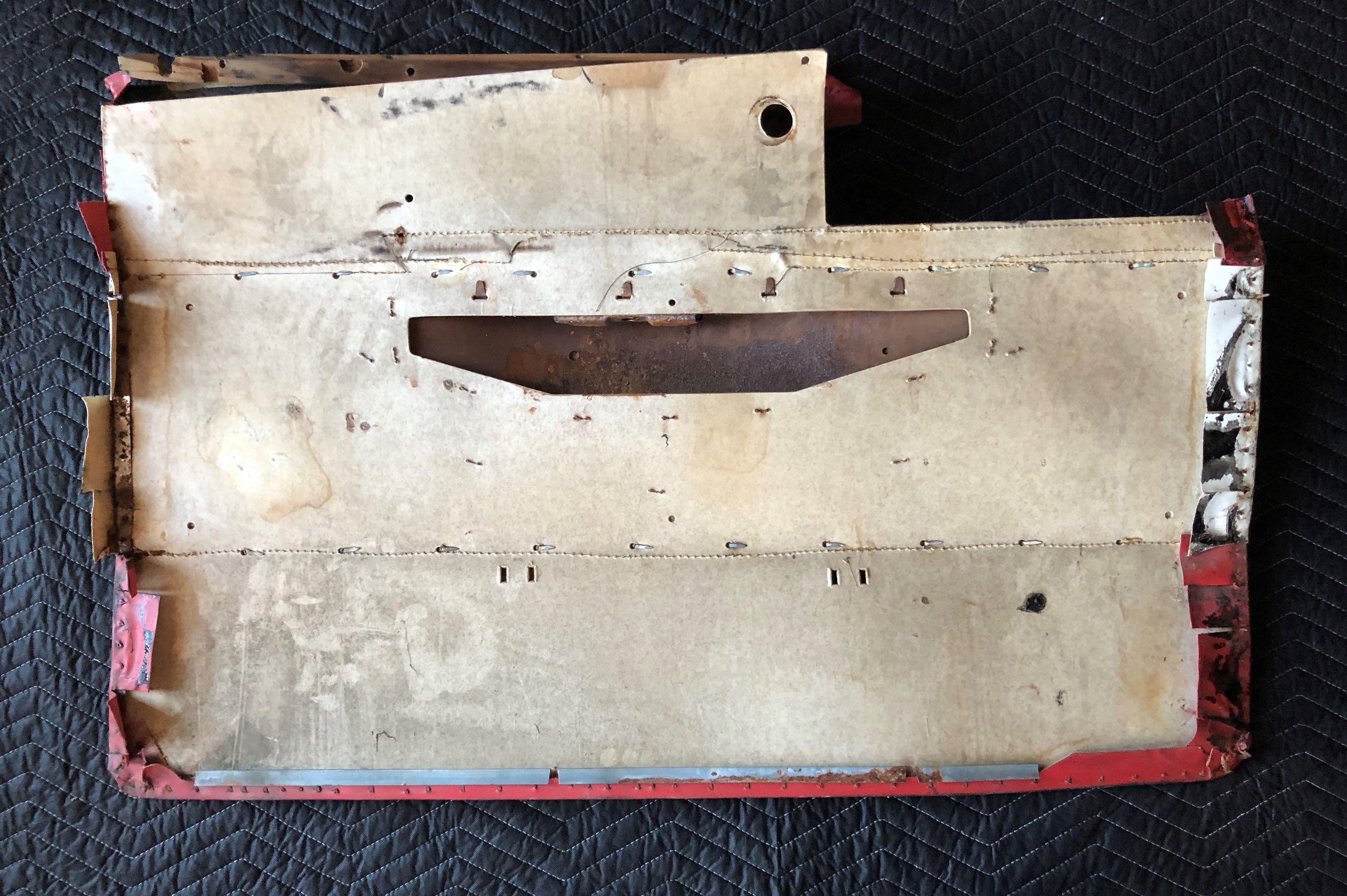

Below are pics of the front and back side of the passenger door panel. You can see the wood strip across the top in the back pic. I e-mailed you some photos as well. I'll have to take some better pics of the driver's side panel that is still on the car to give a better idea of how its all assembled. Thanks!

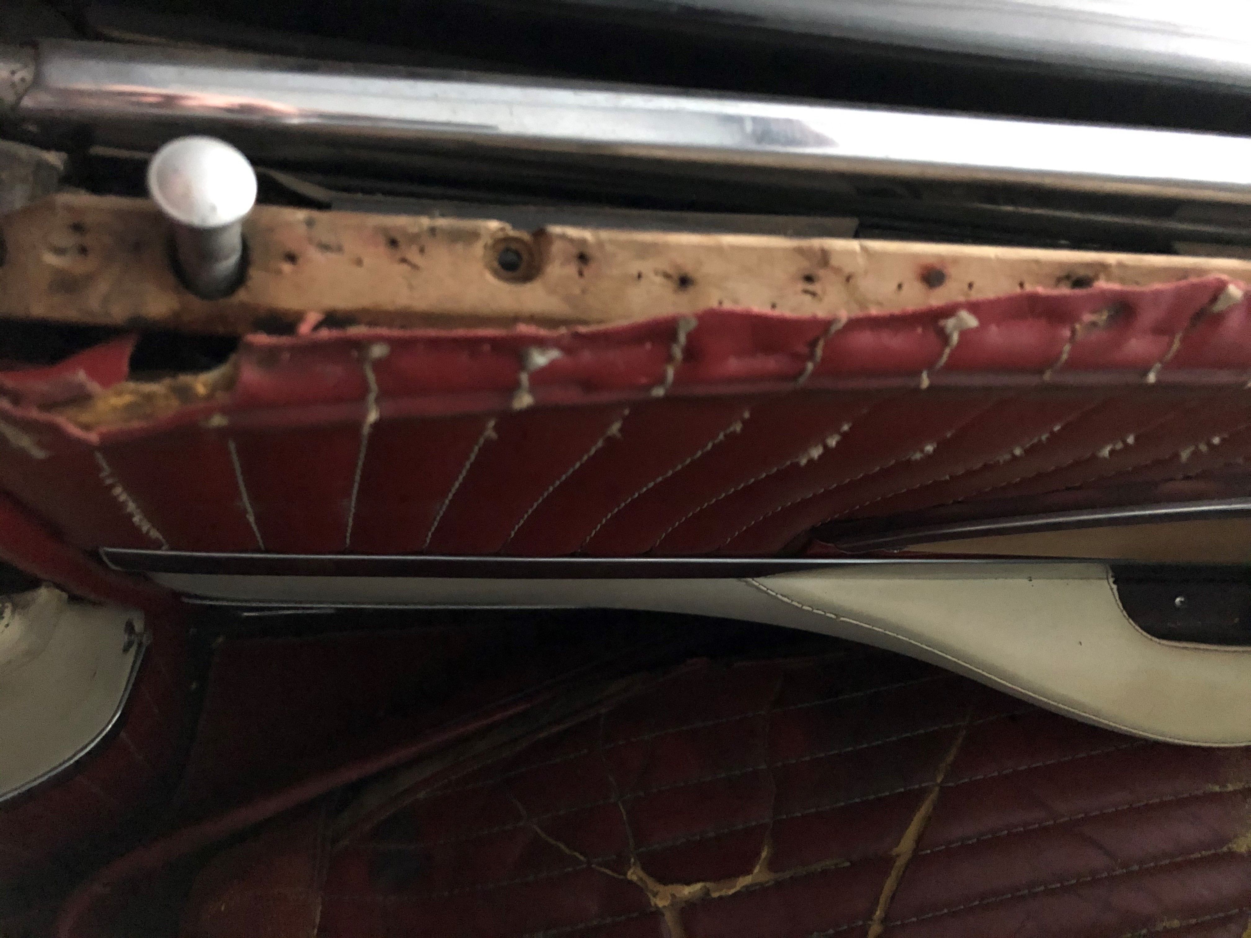

That wood strip is what is known as a tack strip. When they go bad I always replace it with strips of ABS plastic. I use rivets to attach them to the car a sometimes I will also use construction adhesive as well to give it added strength. I like to use ABS strips for this because it holds staples very well and will last basically forever. I show an example of this in the headliners course if you are interested.

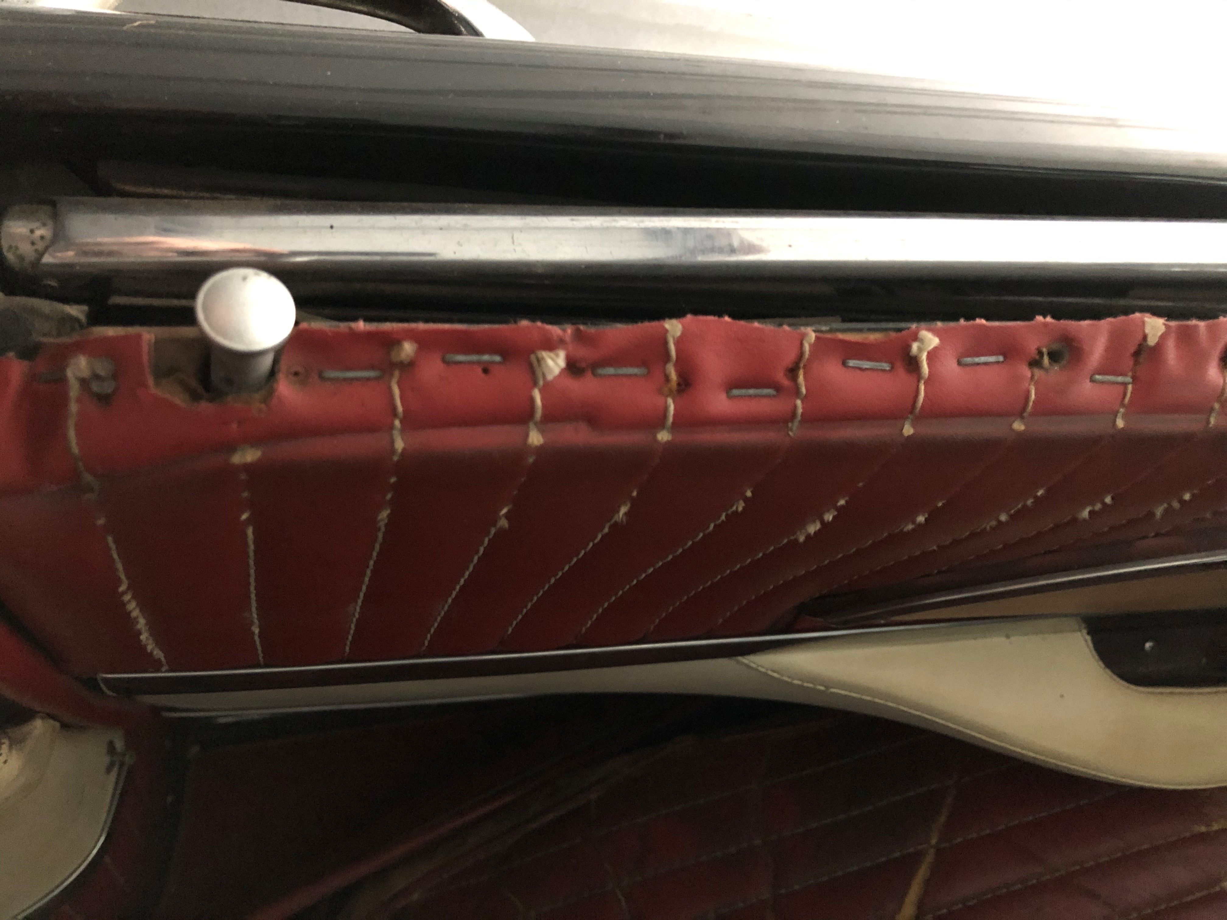

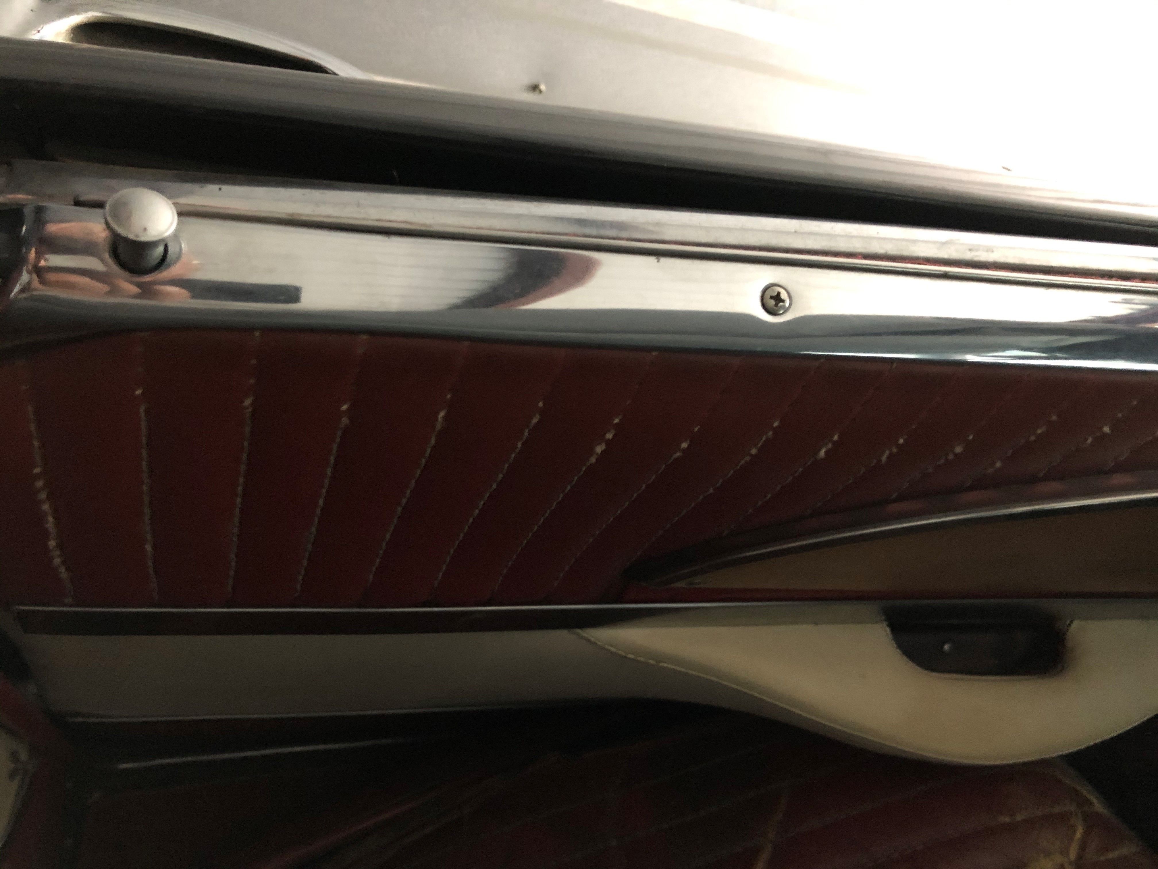

Attached are some pics of the top of the driver's door panel. The first shows the door un-assembled with the stainless steel trim in place. The second shows the trim removed with the vinyl stapled to the wooden tack strip. (On the passenger door the vinyl was nailed on with carpet tack brads so I'm assuming some work was done at some pint in the car's history that required the driver's door panel to be removed). The third shows the vinyl removed with the wooden tack strip exposed. I like John's advice of replacing the wooden strip with a piece of ABS and will likely go that route.
