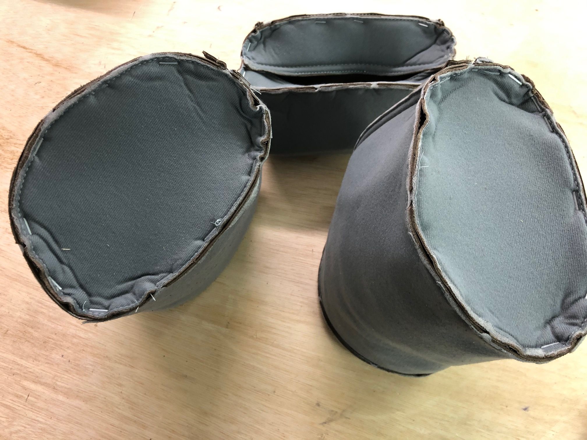

I am hooked to stapler. Cannot do without one :) But seriously. First I had this stapler(I paid $10 not sure whats up with prices) which didn't last at all with upholstery. It constantly jammed, had to clean out after each staple. Finally side hooks just broke off:
Now I got this one and it is monster!
However, with this one I have to "squeeze" each staple with pliers to make it flat before sewing. And then it is real PITA to pull staples after sewing. I feel like tons of time wasted on stapling and removing staples. But I have no issues sewing any kind of complexity parts.
So, I am trying (on simple parts) just to align them with my hands but for headrests or any other small parts with curves when I have scrim foam, etc I feel like I need it.
Do pro's use this method? (I found this tip in Chechaflo videos)
And if not, how do you get off it? I am perfectly fine with tape as allowance guide. I do French seams using edge of a foot. So, I'm getting faster. But this stapling just kills me.

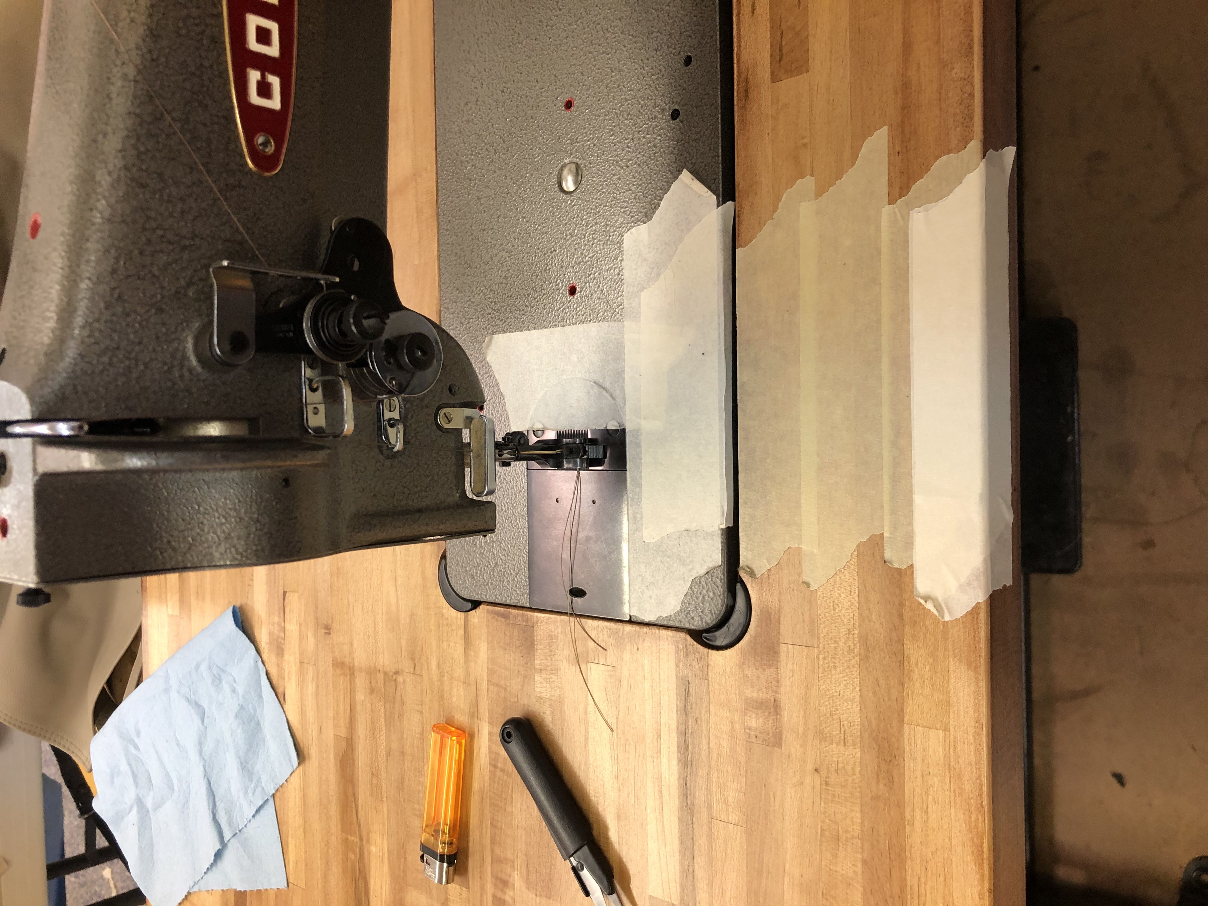

I’m no pro but I tend to align by hand, I don’t like the thought of staples dragging across the bed of my machine. Sometimes on real tricky stuff I will staple so the sharp parts end up at the top.... and then pull them out when they get close to the needle. Maybe just a tad obsessive compulsive :astonished:
#10708
I do worry about it too. Especially with those HD staples. I staple on edge so I rarely touch it with machine foot. And I have tape on table and machine...
By John Long
#10709
I would take the tape off. Your machine does not need to be protected. It is built to take ten times the punishment you are going to give it for years.
My concern is the bottom layer of material needs to slide freely so the feed dog can move it at the same speed as the top layer. If you add the friction of that tape to your work, you will need to staple it in order for it to feed evenly. :smiley: Some trimmers actually keep silicone on their machine to help the material slide.

Maybe machine will last but I don’t want it to look like attached. My Consew looks brand new or close. No need to put scratches.
As far as friction. Masking tape probably has lower friction than painted surface. And there’s definitely no friction between masking tape and sewing foam.
