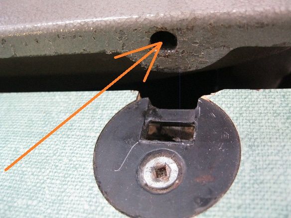

I need the hinges that bolt to the Juki base and then lock into the table to allow the unit to pivot. Not sure what they are called, if they are universal and where to purchase a set.

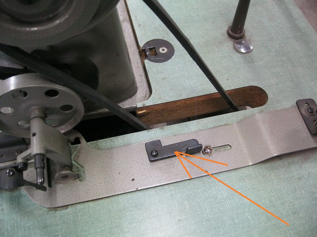

Also....what is the purpose of the lever on the bobbin threading attachment?

The lever looks like it may be an forward and aft adjustment lever. Loosen the two mounting screws and see if the lever moves the assembly forward and back. I can't tell from the pic but you want it adjusted so the wheel is touching the belt when engaged and not touching the belt when the full bobbin trips it to release.
