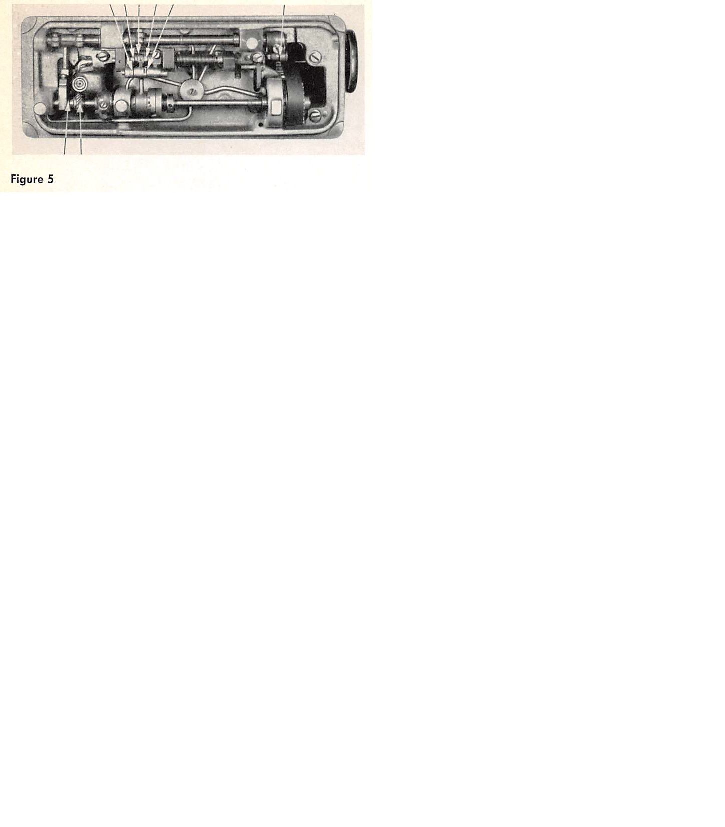

Tip your machine back and see if you have this adjustment underneath
If yours doesn't look like that then the adjustment will be on top where the main shaft connects to the reverse assembly. I will try to find illustrations on that style too
