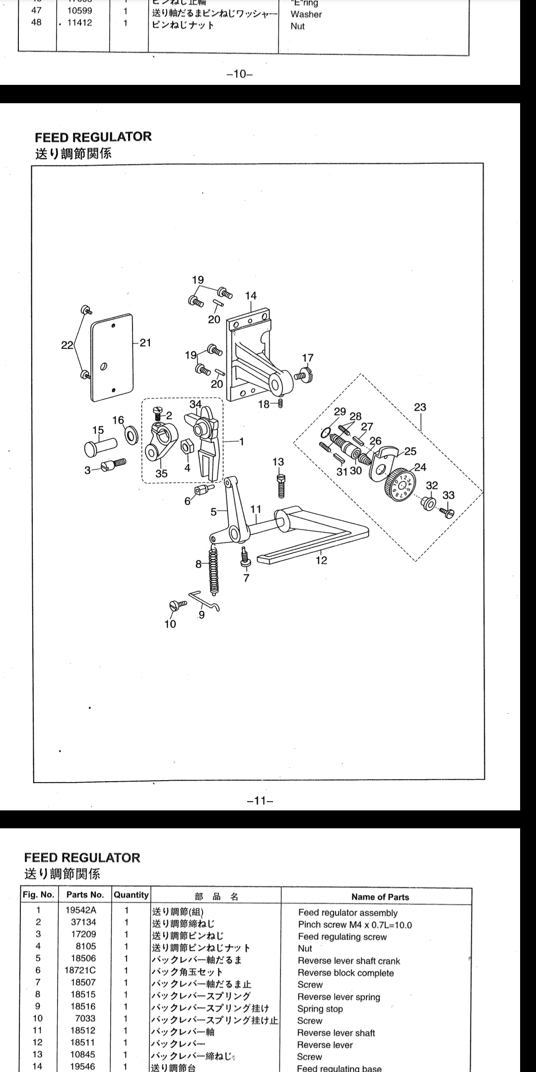

Hey guys just joined the forums. hoping someone can help me with my conseww 206rb-5. this part came out of the back and i have no clue how to put it back together. if someone could please help or provide a diagram that would be greatly appreciated. thank you

Dont follow that video for hook timing!!! This is not the correct procedure, although there are machines that are timed that way, he is not reading the manual correctly. There is a v-groove in the shaft where he is working andthe set screw must lay in it, when you make a small adjustment and tighten the screw, it will fall back into that groove right back where it was negating the adjustment you thought you made. The manual (that he is referencing in the video) says to loosen the 3 set screws on fig.5 screws "k" to adjust timing pictured here
The screws he is messing with are for adjusting tbe hook/needle gap, not timing. Always check that the saftey clutch is engaged before adjusting timing
