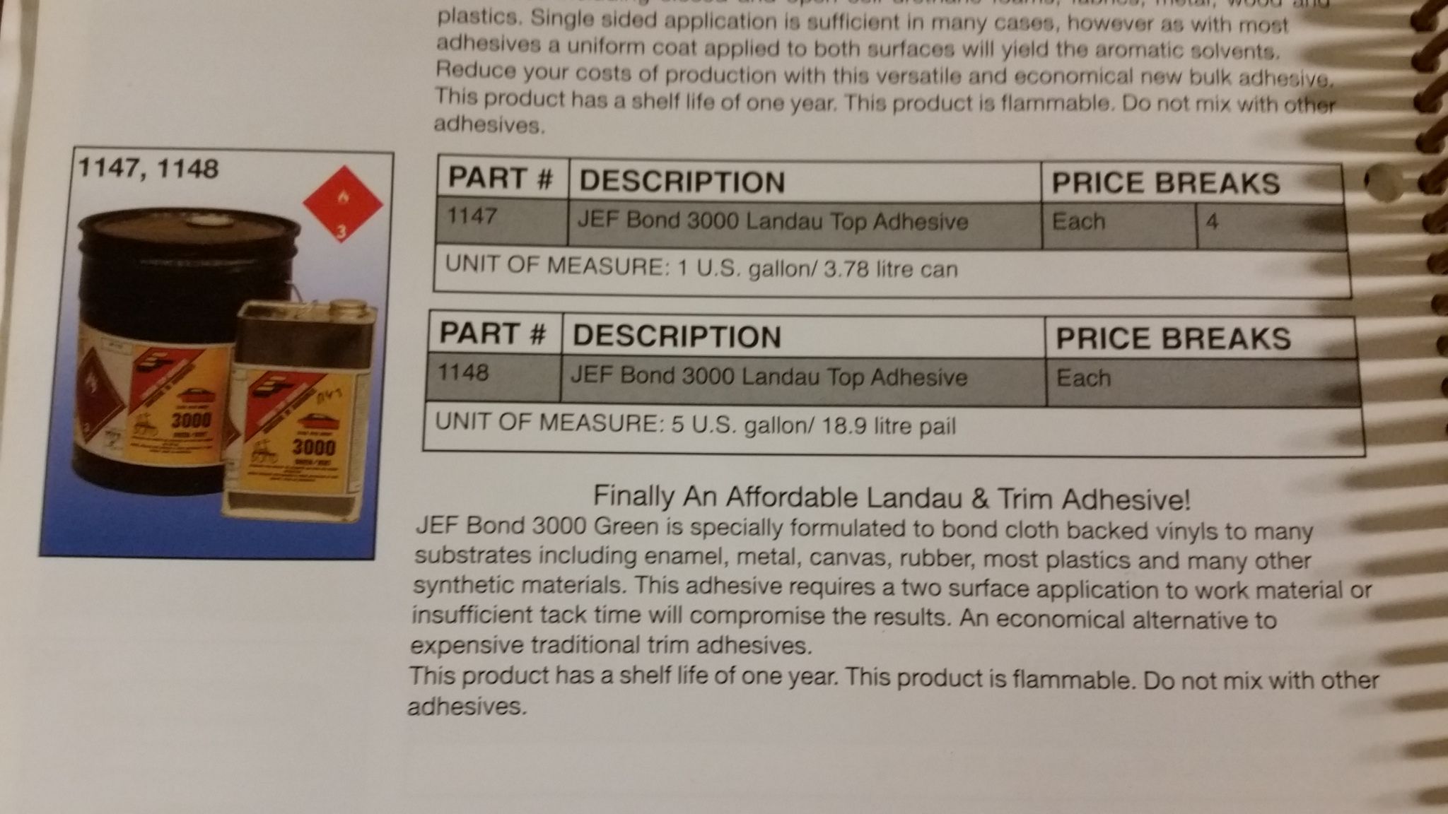

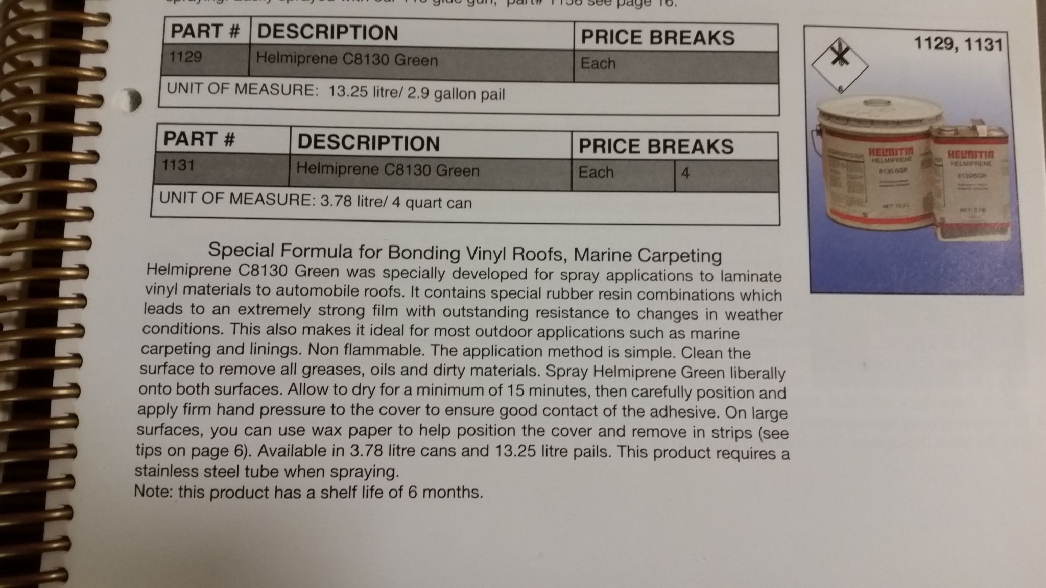

I have a couple choices of glue (I'll attach pictures ) do you have opinions on either one?

- I would use the landau top contact cement.
