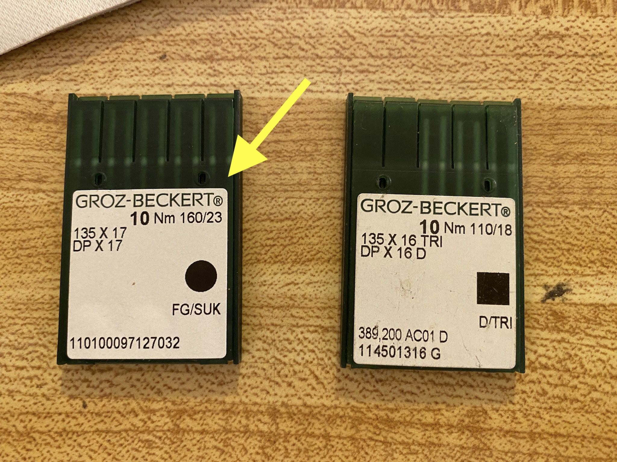

I am starting to do marine upholstery as a side business and now am using my machine (Consew 206RB-4) more frequently and on a wider variety fabrics, etc. I've often wondered about the size of needle that I should be using.
My machine (Consew 206RB-4), that I bought used, came with what might be considered a life-time supply of Groz-Beckert needles - 160/23 and 110/18 sizes. I have used these needles on several projects so far. I typically use PTFE thread (Tenara) either the standard v92 or the heavy v138.
I have found that the 138 thread only likes to run on the larger (160/23)needle, whereas the 92 thread is OK with the smaller (110/18) needle. The 160/23 needle seems quite large and I assume that too large of a needle can be a concern, particularly with the tighter stitch lengths. I typically sew 4-5mm for regular seams and 6-7mm for top stitching.
I am not sure of a couple of things and could use any advice or guidance.
- Are the Groz-Beckert needles the right sort of needle to be using for vinyl upholstery fabric?
- Are the sizes about right?
- What do other use on Marine/Automotive Upholstery?

The 135x17 are the right needles for vinyl/fabric. The 135x16 is for leather (different point on needle). The 23 size is ideal for 135 thread. The 18 is a bit small for 92 thread, but will work. You may run into issues with the thread starting to fray above the needle with an eye that small though. The 18 is better suited for 69 thread. For 92 thread, you may want to bump up to 20 or 21 needle size.

I've ordered a supply of #20 needles, as I usually work with 92 and 138 threads. So, instead of using the #18 needles, I'll use the #20 for the 92 thread and I have a good supply of the #23 for the 138 thread.
