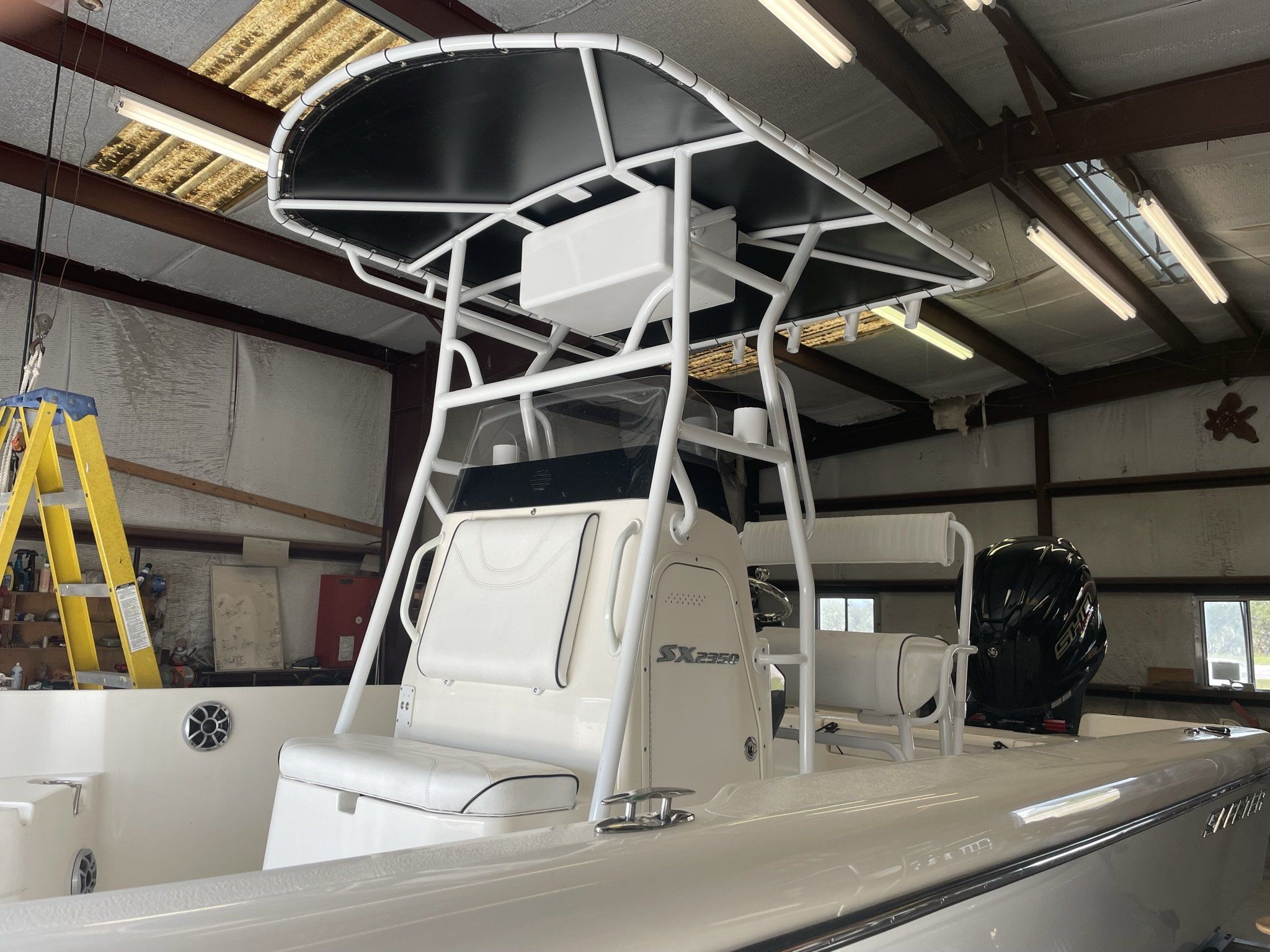

I am very new to sewing. Back story: Husband and I purchased a business in aluminum fabrication for boats. Part of our products include tops made out of Herculite material. We currently have a gentlemen who does the sewing for our tops, but I want to be able to learn how to sew and create the tops and covers for our leaning posts. With that said, I have signed up for some basic sewing classes. Question for my pro's, what is the best sewing machine for materials like Herculite?
