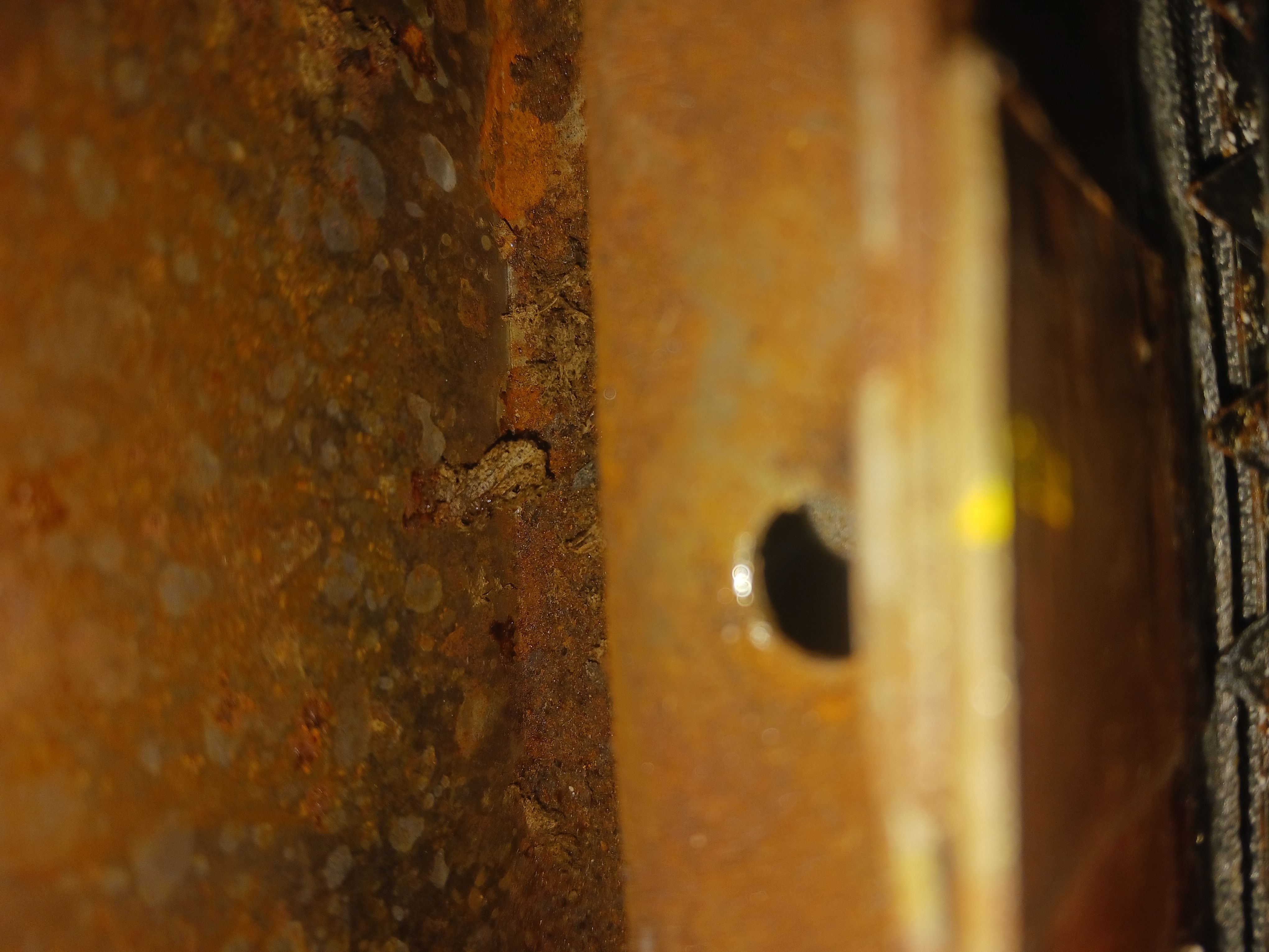

By zanep
#17887
Yellow marks bow hole above lr door

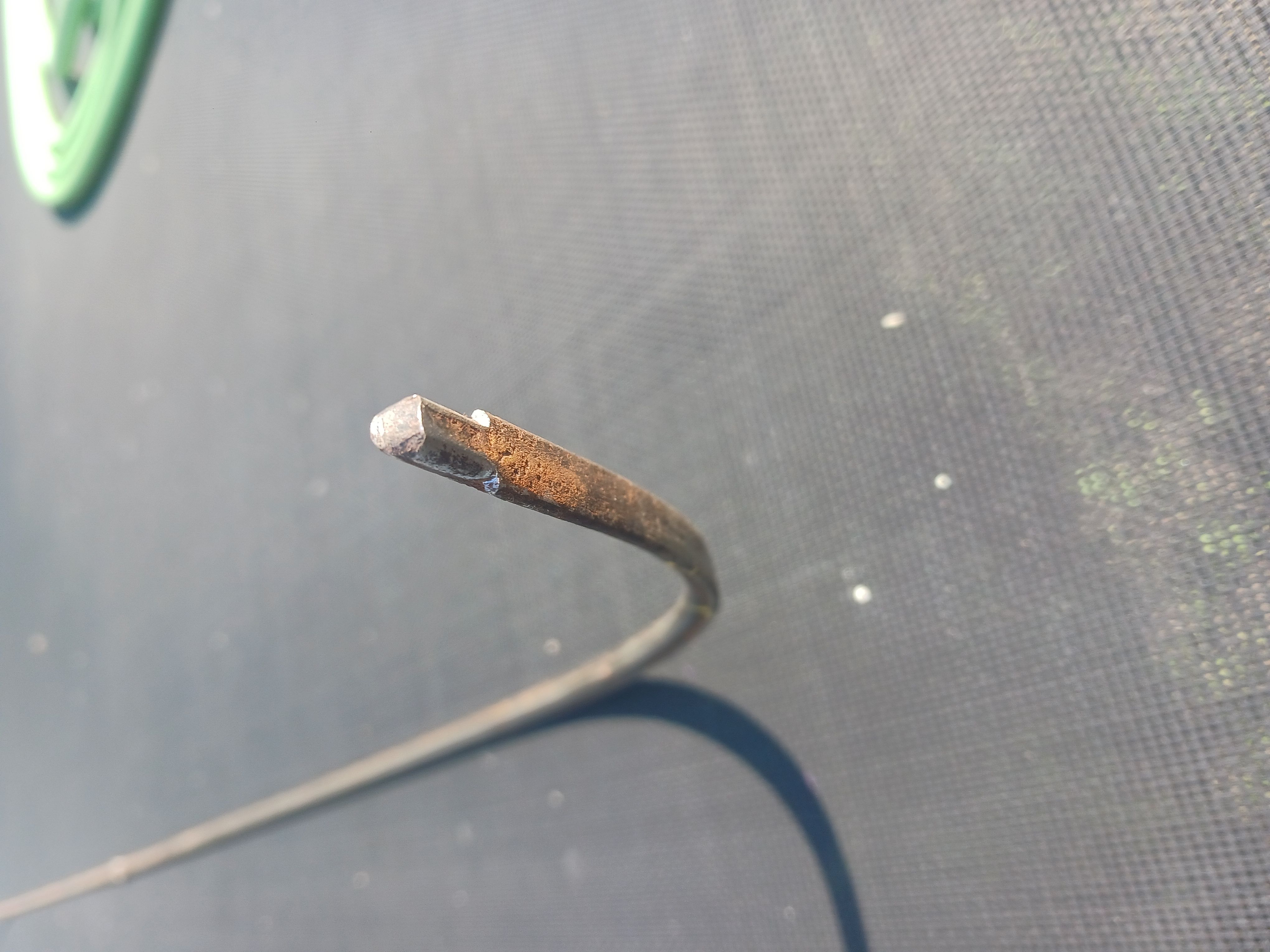

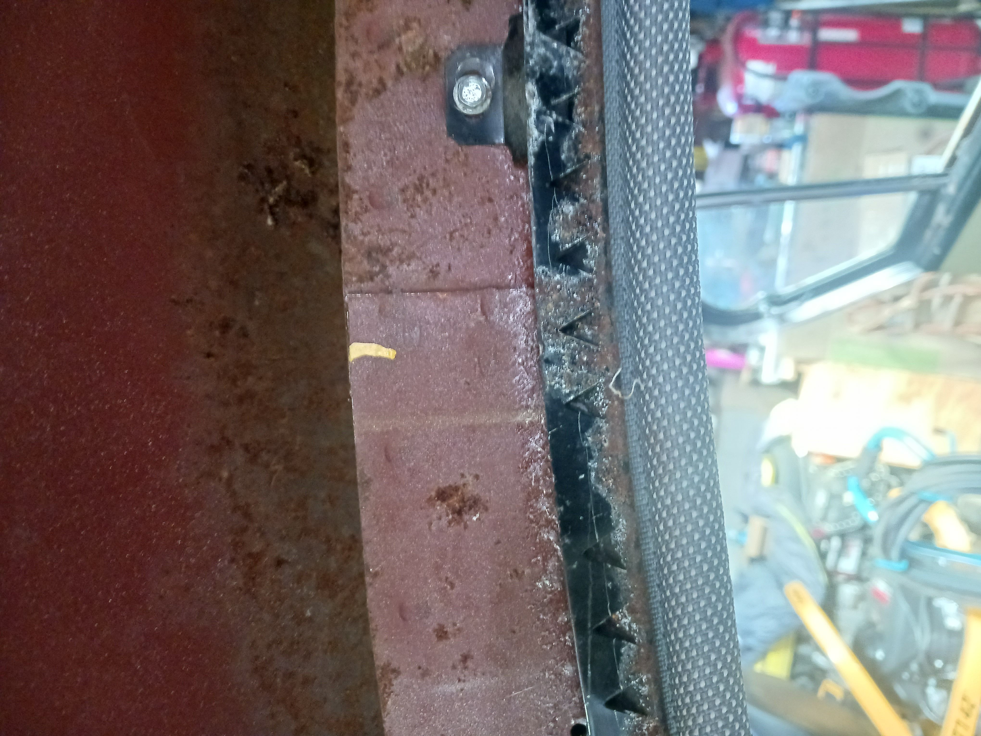

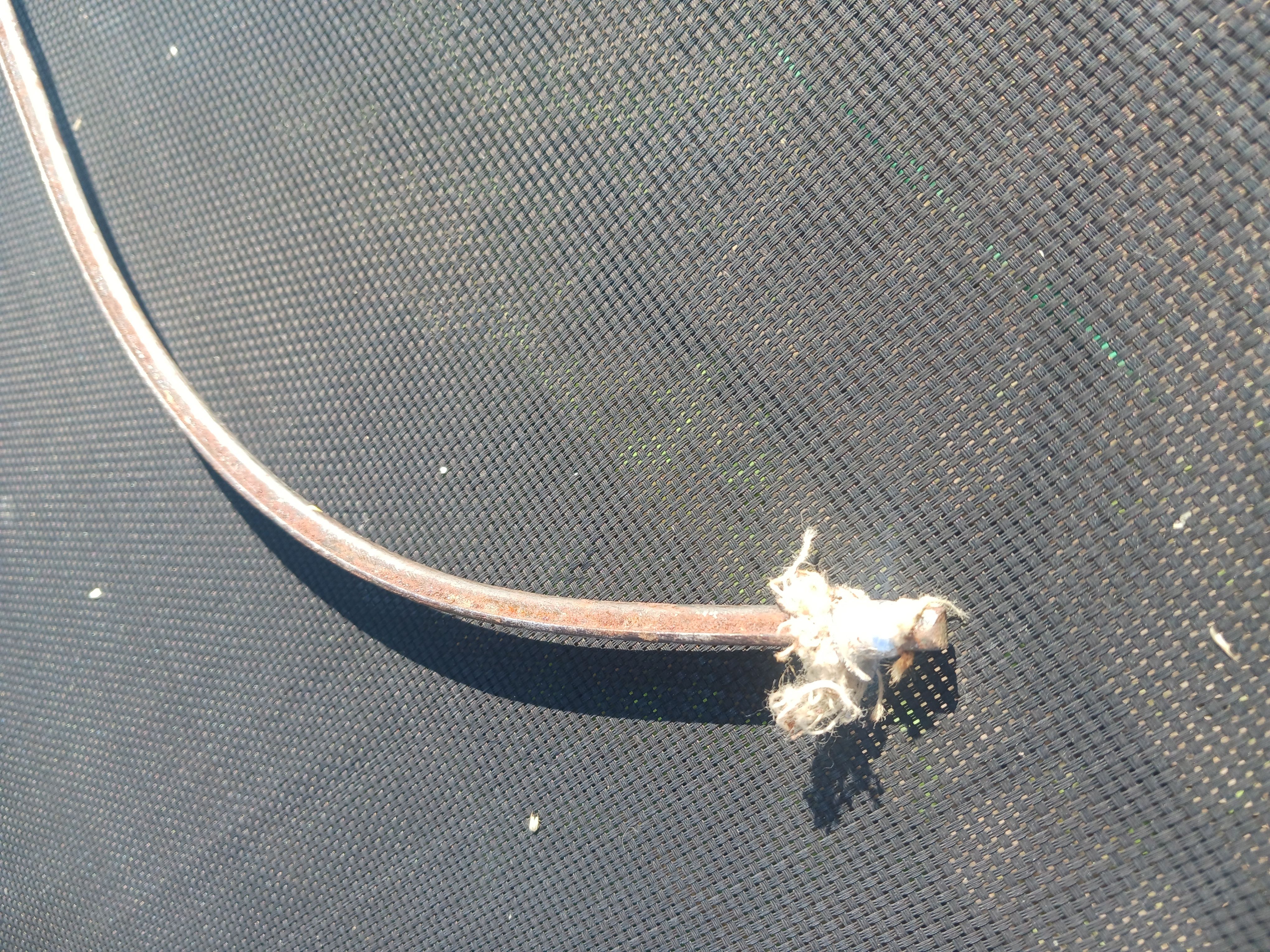

By zanep
#17888
The bow hole above lr door is in a channel
I assume headliner fabric was clamped to the bow end. The extra fabric was tucked into the sawtooth metal tack strip along the sides and glued front and rear.
I have searched online and never found a similar bow set up. In 1957 hudson combined with nash and AMC. None were popular cars at the time, going out of business. I found a pre cut headliner but no hardware or instructions.
Any help or suggestions are appreciated.
#17894
Looks like there must be an upper windshield trim to cover the front of the headliner. If there is no trim the material must go in under the windshield rubber. The rear around the back glass could also be the same. As for the sides, not quite sure what hides the edges.
You might try the Hudson forums for more info. The headliner suppliers may have the info that you need. It will be about 3 weeks before I go to a custom car show and I know of a couple of Hudsons that I can check out. I know you want answers now, but that is all I can dofor now
