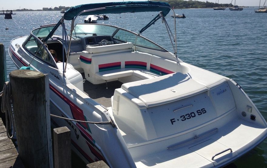

I have a 1996 Formula 330 Sun Sport power boat that I'm re-upholstering (the current vinyl is 23 years old,getting brittle and starting to crack). So, I thought I would start a thread to share the project and seek some advice along the way.
The boat has a fair amount of seating in the cockpit

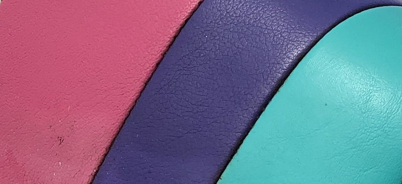

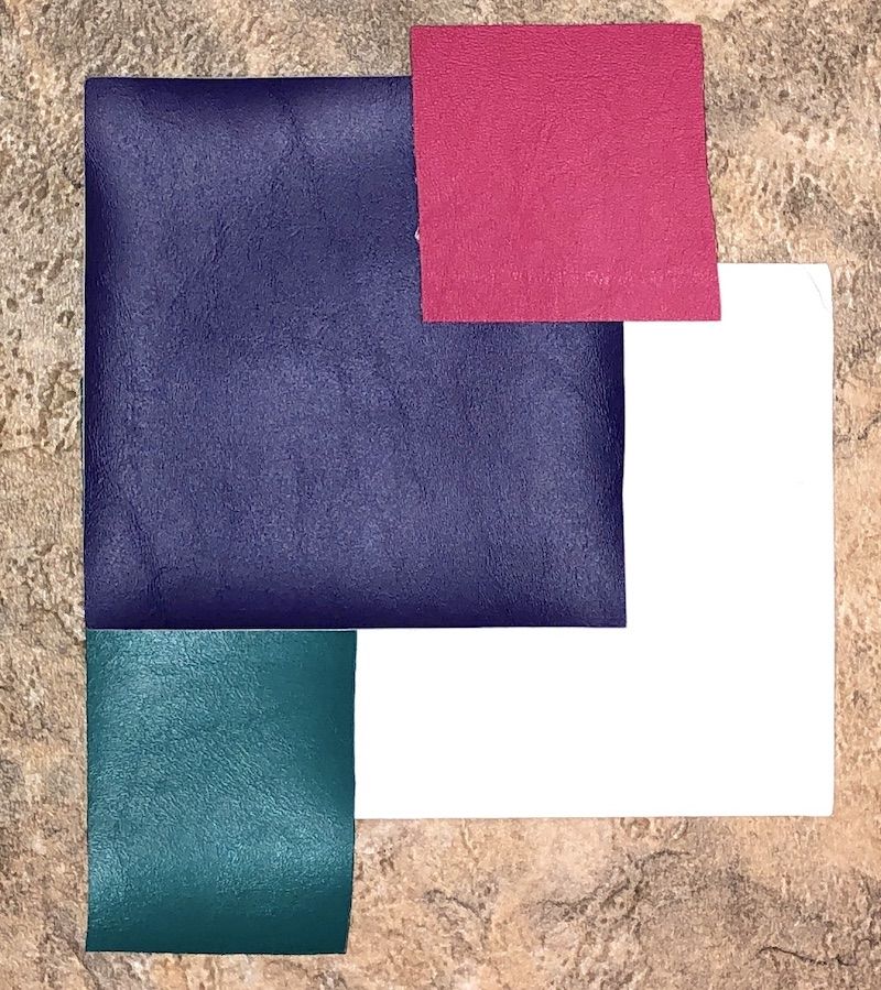

I contacted the Tech Support folks at Formula Boats to see about the vinyl colors. The color scheme is a bit dated (pink/purple/seafoam green), but matches the exterior of the boat, and as such, I wanted to stay close to the existing color scheme.
The colors are discontinued, but I was able to get some leftover stock of the pink and matched a purple, but not the seafoam green. I settled on a darker green. So the colors are Nautolex 'Bright Ruby' (pink), Morbern Seabrook 'Purple',Morbern Seabrook 'Deep Sea’. The white is going to be Morbern Seabrook 'White'.

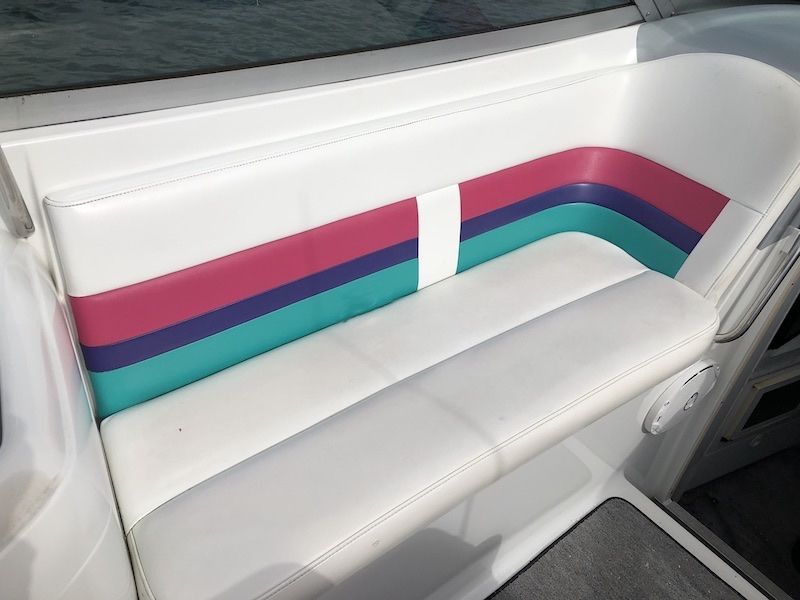

Here is the previous design:

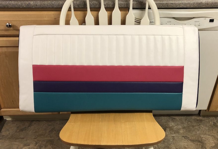

I also made a mock-up of the seat panels for practice (using some spare vinyl) to see what they would look like for real:
I have ordered/received most of the supplies. I am using 'Heavy Tenara' thread (approx 138) and the machine runs a Nm 160/23 needle. I also have some 110/18 needles. I wanted to go with a fairly heavy thread for the vinyl and the canvas, as it will get a fair amount of UV exposure over the years.

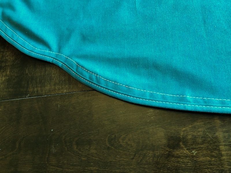

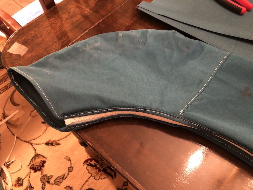

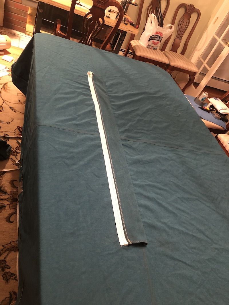

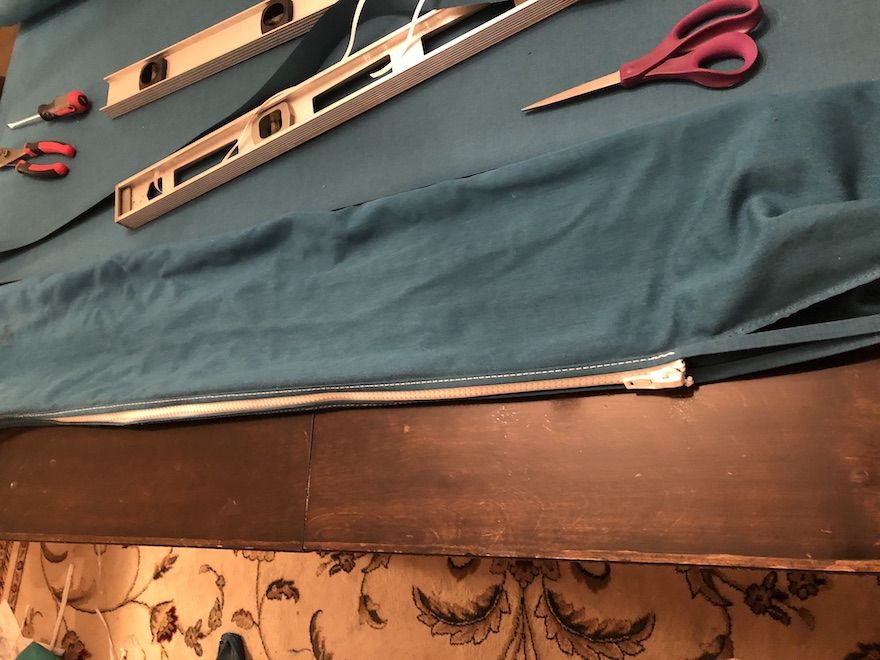

I am working on the canvas first, before diving into the vinyl work. The bimini to needs a new set of zippers. Most of the zippers are 48" YYK #10 . . . a few are a bit shorter, so I am starting with a 48" zipper and cutting it down and placing in stops.
I've done 4 zippers and am starting to notice a problem . . . I am getting an intermittent tension problem on the top stitch. It is fine for most of the 48" run, but along the way the bottom tension wins out and I am left with an extra length of top stitch that shows on the bottom (maybe about 4-5mm, 1/4"). This will proceed for about 10 stitches, then the tension will return to normal. I have tightened the top thread a bit, but it seems to keep happening.
Not sure if this is a tensioning problem or something else :thinking:
The needle is 135x17 (Nm160/23) and the thread is 'heavy' Tenara (138).

Thanks Guys,
I did find a couple of problems with the thread tensioning and the bobbin.
1) the bobbin spool seemed to be a bit warped, which made it turn with uneven tension in the bobbin.
2) the top thread tensioning disc got dislodged (somehow) and hung up on the little pin that the thread is supposed to loop around. So the net effect was less contact area on the thread for the tensioner. I didn't realize the issue until I looked at the tensioner closely.
I replaced the bobbin spool and reset the top thread tension. The latest zipper seemed to do fine. I am finding that the Tenara thread is a bit temperamental, especially when working with canvas (Sunbrella)
I am winding my own bobbins from the large spool of Tenara.

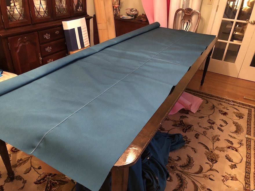

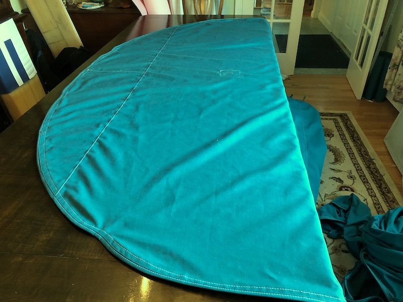

The mooring cover is in process . . .
So far, I have made a large piece (16' 3" x 9' 6") out of four (4) 60" wide panels of Sunbrella.
Next steps will be to trim it to the shape of the existing cover + 2" hem. I have 1" wide webbing to use in the perimeter hem.

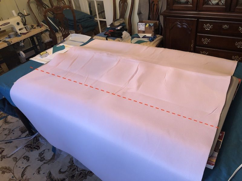

I should be finishing up the canvas work over the Thanksgiving weekend (USA) and just thinking ahead to the vinyl work. One preparation step that I need to consider is 'gluing' the sew foam to the vinyl.
I have:
15 yards of white (54" wide)
4 yards of purple (54" wide)
5 yards of green (54" wide)
4 yards of pink - which already has a foam (only) backing . . . so I may want to apply a scrim cloth layer.
All needing to get the sew foam glued to it. My plan was to glue the sew foam onto the material in bulk fashion, prior to doing any cutting of pieces, etc. With that much material, space considerations come into play as to how to apply glue and then the sew foam. I plan on using a water-based contact cement as that should give me the ability to adjust the positioning of the sew foam before it completely sets up . . . (vs. solvent based contact cement which tends to adhere on contact).
My 'work' table is 9' x 42" . . . and I could possible add a couple of tables along side it to get to the 54" width. Then I could apply the glue to about 3 yards of vinyl at a time. . . . and then roll out another 3 yards, etc. Still a lengthy process, but probably do-able.
Just wondering if others who are more experienced in working these types materials (vinyl fabric & sew foam backing) had other ideas.
FWIW - I purposely did not buy the foam-backed version of vinyl, since it did not have the scrim layer that the sew foam does. . . . seemed like I'd be in a similar predicament applying the scrim to 25 yards of material.

I'm moving on to the vinyl upholstery. First thing was to take the wrinkles out of the sew foam. It comes tightly packaged and you have to let it sit for a while (1 week) after opening it so that the foam expands back to its normal thickness. Even then there are still wrinkles in the sew foam. I found that a steam iron on a medium setting takes out the wrinkles nicely, as you can see in the picture below. The red line is the border between the ironed and wrinkled areas.
In total, I ironed 25 linear yards of the sew foam :rolling_eyes:

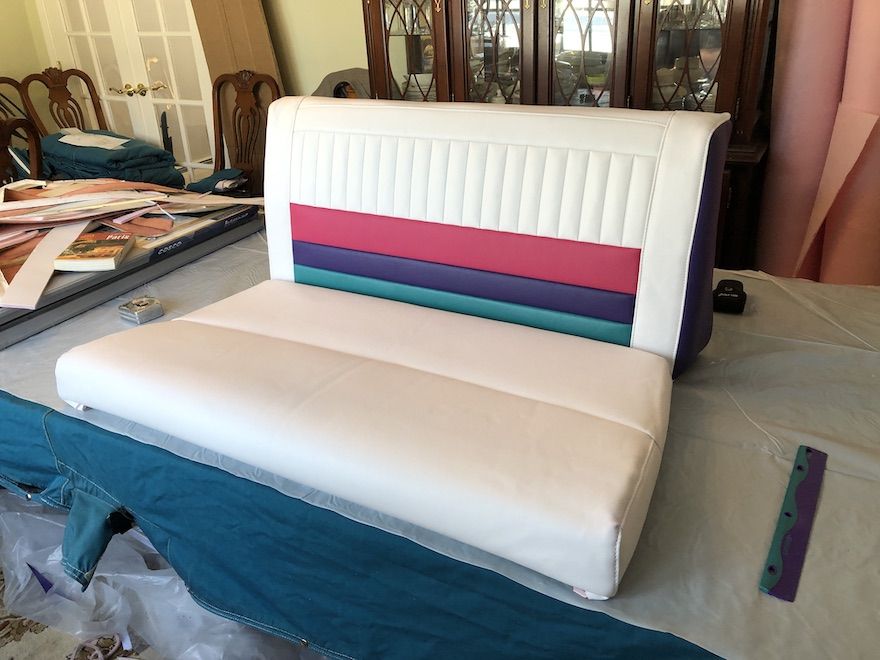

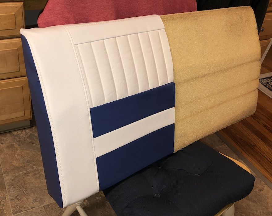

Here is my first attempt at the vinyl skins . . .
I had some trouble with the top stitching and the end pieces. So, this one might be just for practice :rolling_eyes:
I'll take the learnings from this skin to make some changes to the patterns and the stitching.

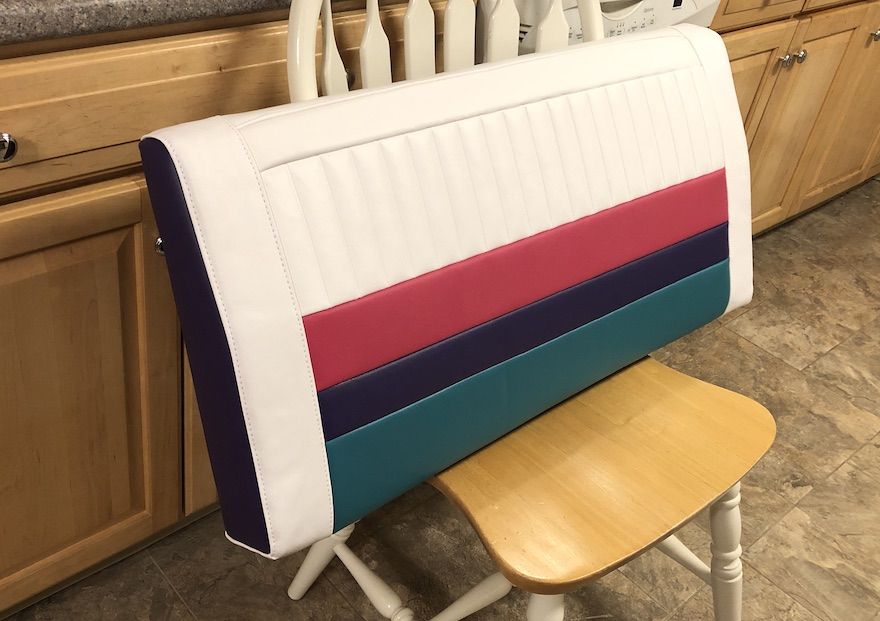

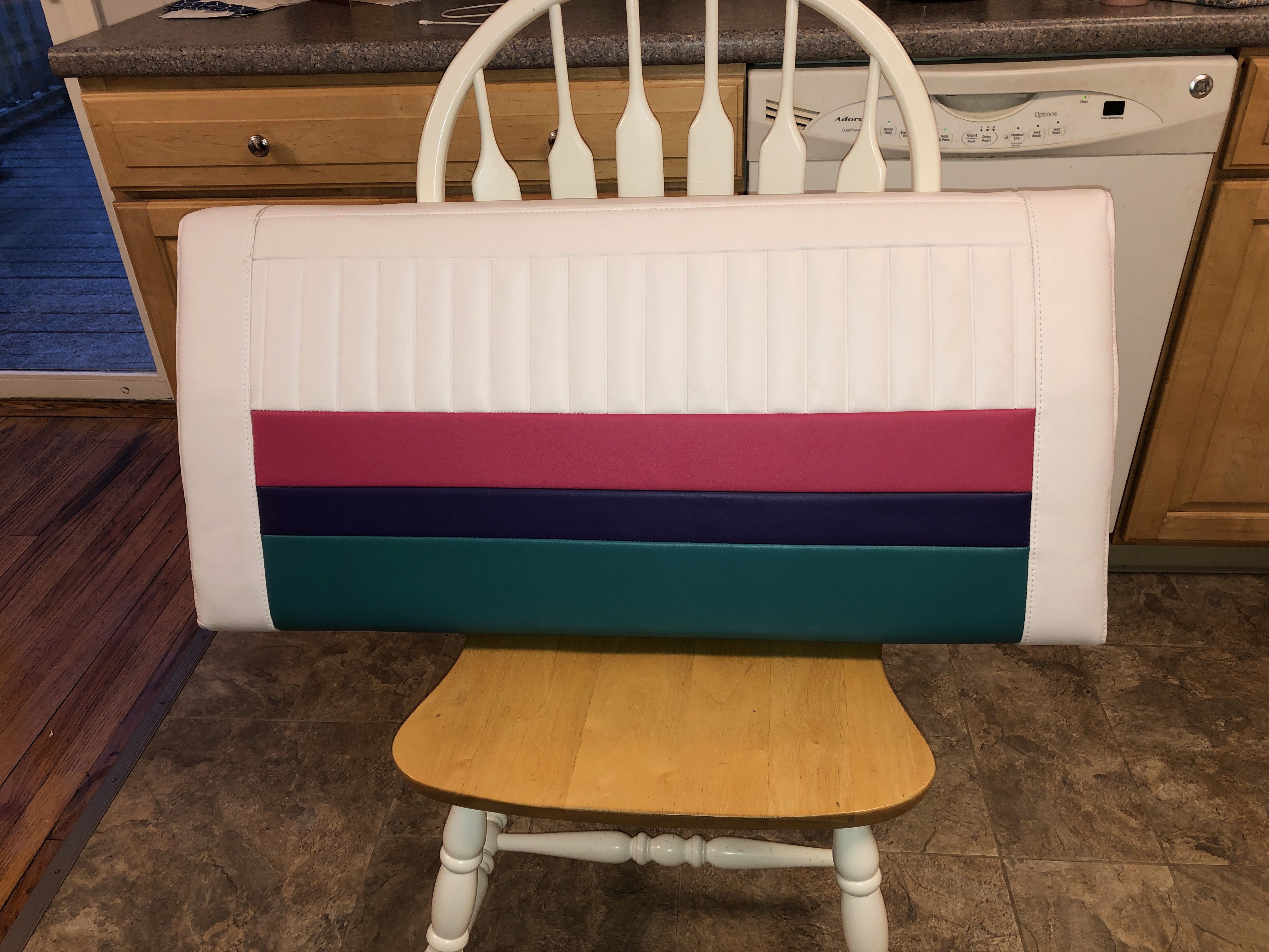

#6519

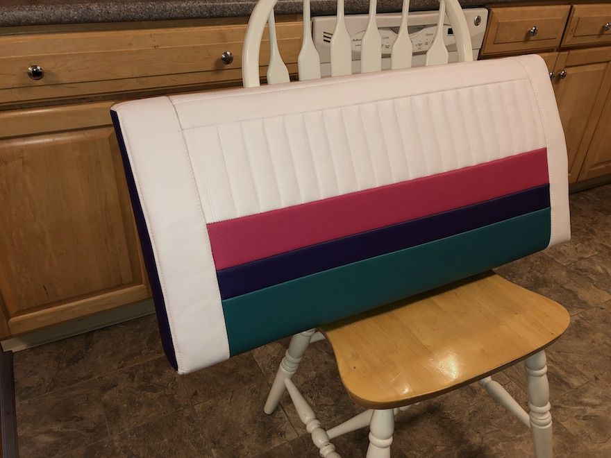

Here is my re-make of the previous skin.
I got the top stitching much better than the previous attempt. This one will be a keeper.

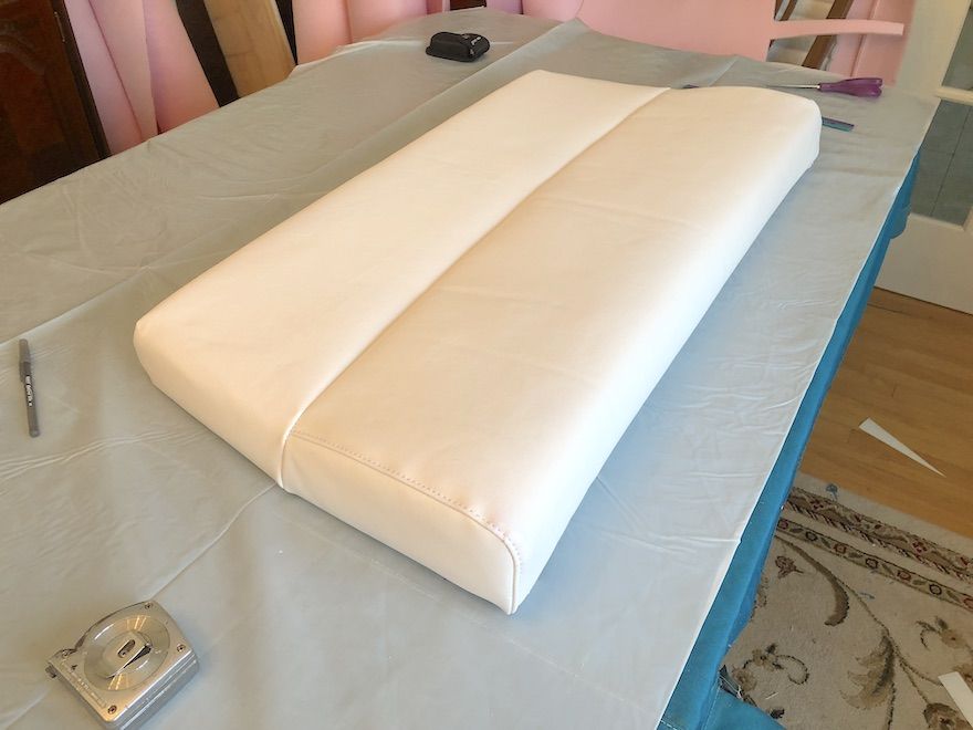

I got the matching base to the seat back that I made done . . .
Here are the pieces
IMG_3710 2.JPG (60.78 KiB) Viewed 79325 times
Here is the completed seat.
Here is the pair . . . Seat back & Base
I am still having trouble with the sharply curved areas. I tend to get a wrinkles or 2 in the seam.

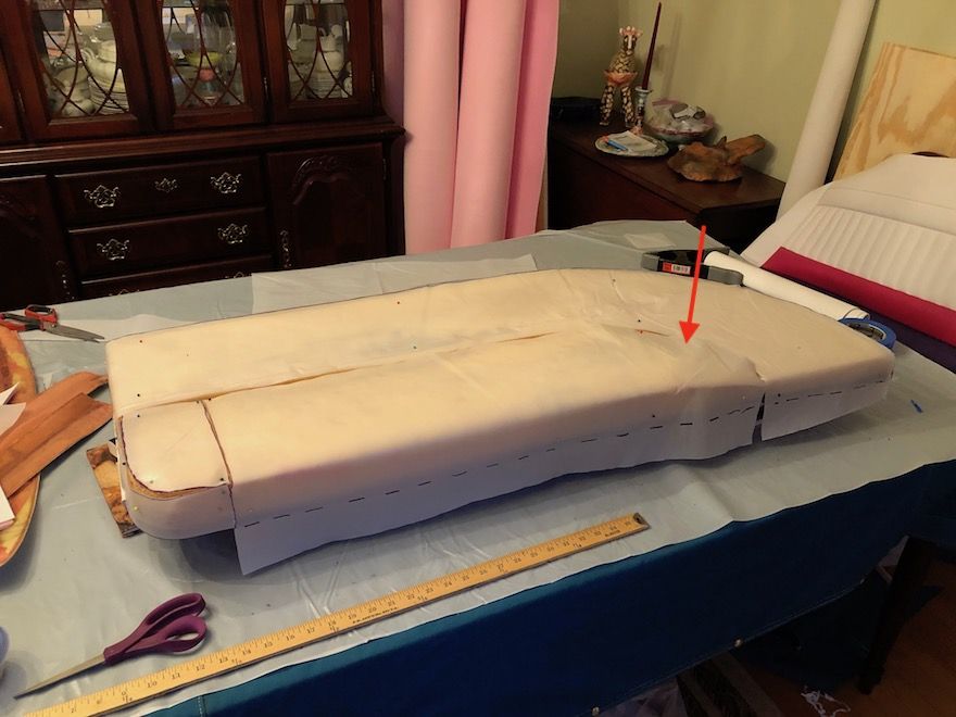

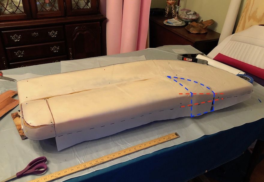

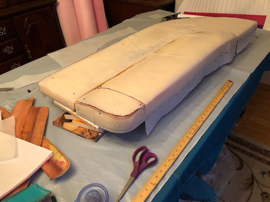

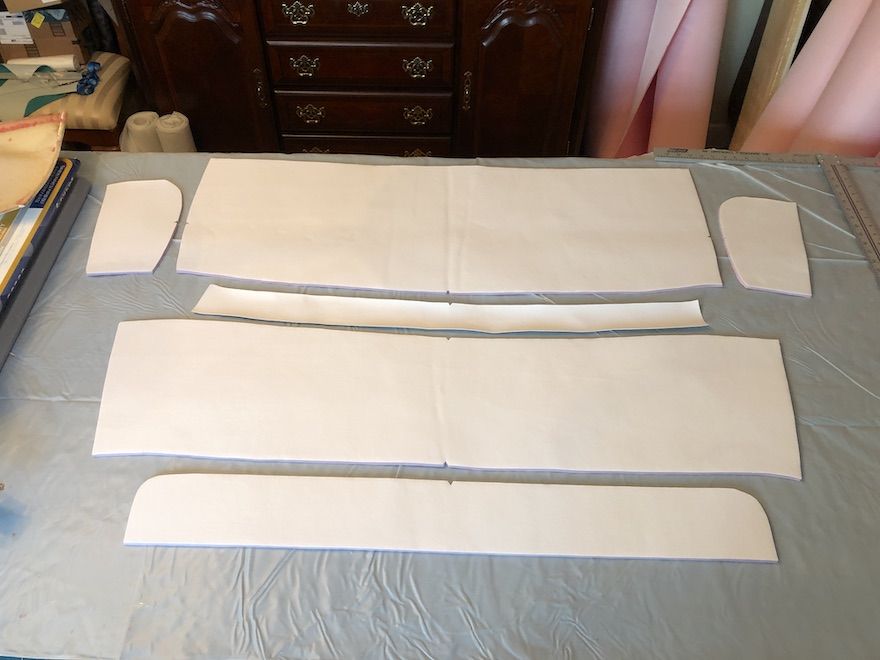

There are 4 seat bases to the main seating areas of the boat. I moved on to the second of the 4 and used the vinyl pieces from the old seat as templates for the new vinyl.
That approach did not work out and the resulting piece was unusable. So, I am now strictly using templates that I freshly make from the foam/bases directly, ignoring (for the most part) the old vinyl.
Here are a few pictures of using 6 mil plastic sheeting as the template material, mimicking the OEM patterns.
I did notice one area where the OEM pattern does not conform well to the contours of the foam. The boat manufacturer, obviously did some stretching of the vinyl to conform to the desired shape.
The red lines show the area where the foam changes shape along its leading edge. I plan on making a separate piece (shown in blue lines) to better accommodate the contour of the foam.
