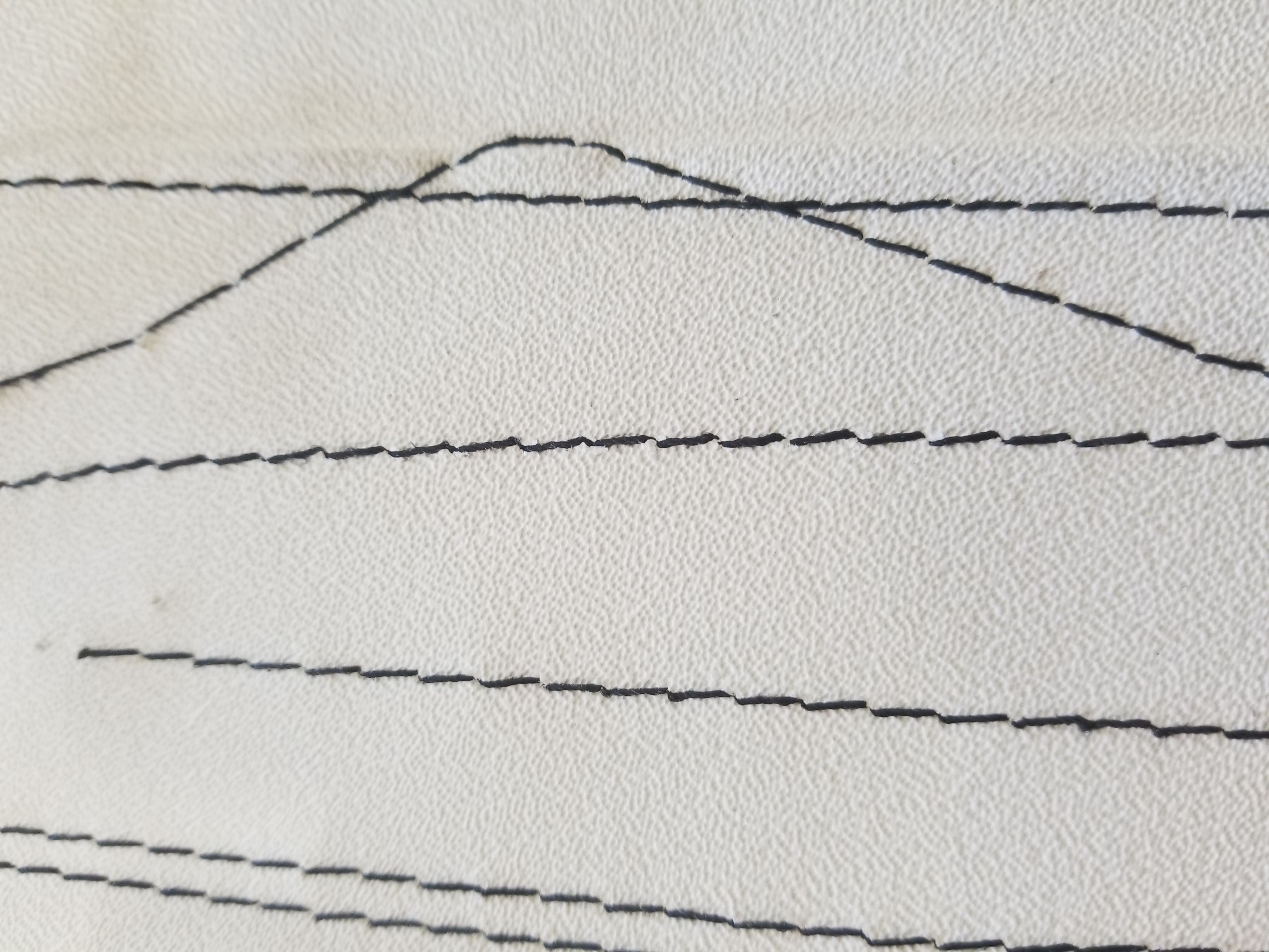

I just bought a new Seiko machine after 20 years on and off (mostly off) using a Chinese knock off of a Sailrite LSZ1. I just started the apprentice course. My question is in your opinion, are these stitches straight and if not, what am I doing wrong. I am not concerned about is the line straight. I am concerned about the slight z pattern in the stitches.Image

That’s common on certain machines. I can’t remember where but there are types that have the z pattern and machines that are straight. I don’t think it can be changed either.

It's the type of needle in the machine. It's called a reverse twist point needle. If you want a straight stitch use a round point needle.

The Needle? Really? that is very intriguing. I just bought the machine. It is a straight stitch walking foot and the needle is the one that came in it. Could you expand on the needle a little?

#9688
